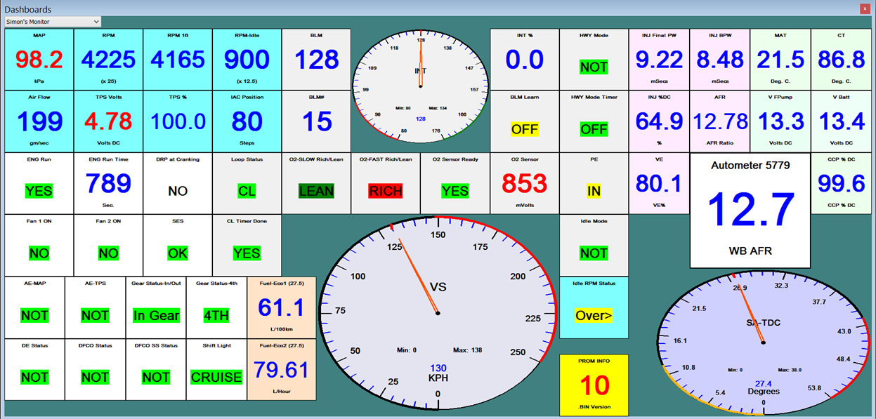

Start up, idle, drive warm, cold etc.. .it really burns the eyes. no SES light. I noticed on the scanner it shows lean and rich then lean and goes back to rich a lot in closed or open loop..scaner was really a good investment
O2 sensor voltage will always swing from lean to rich in closed loop. It should be a consistent swing. It's called O2 cross count. The swing is slower in idle mode. In open loop and PE, the 02 sensor is not taken into consideration, so the ecm is blind. You should be richer in open loop and closed loop but not to a point of soot and eyes burning. Best way to see if you're too rich is spark plug and O2 sensor inspection. Overly rich condition will blacken the hell out of them (dry not wet black). Scanner might not be able to catch that swing. Can you see the BLM on your scanner? That would probably be called something like Fuel Trim in percentage +/-. Also, would be nice to get the Target Idle RPM. That's the only way you'll know if the ecm is commanding an elevated idle or the idle is elevated compared to target. Again, if you could datalog, we could see what's going on.
Hmm, I need to look into this. I believe I saw those readings on the scanner. But like GD said, seems its not that good for OBD1 vehicles (regarding the MAF reading it gave)

BTW, how do you get this? Its just download the software, hook up cable to laptop / car and you can read data?
Old Nov 4, 2020 | 03:20 PM
That’s my own custom made ADX view. If you download i believe it comes with premade ADX files

Originally Posted by vinny R
I am not positive on what was changed. Tuned Performance did my tune. He did make sure what injectors I used so he could set it to the Delphi specs, Voltage offsets I think? When I ran my datalogs the BLM's where rich and the car smelled at idle. I think Brian did something with the fueling in the VE tables.
This is interesting!
If the BLM are "rich" it means they are pulling fuel right (<128)? That's my understanding. So if it's pulling fuel, the idle should not "smelled at idle" since the close loop is doing it's job. Unless the ecm taps out and can no longer pull the BLM, thus SES light comes on. Was it smelling in open loop or all the time?
Don't mean to be an a**, just curious to understand the logic.
Cheers
Cheers
I am still trying myself to understand the logic, part of my learning curve so no worries.
It smelled @ idle while warming up. The smell got less after it went into closed loop but it still had that rich smell. It also would hesitate off idle from what seemed to be the overload of fuel, this also got better as it warmed but never would totally go away. Yes the BLM's were low but the ECM did not tap out. IIRC it was @ a low of 118.
When Brian read my initial datalog he said that he would bet it smelled @ idle so something in numbers was telling him this.

@vinny R on your friend Bosch 3 injectors I changed offsets and be. On your just recurved timing alittle and worked on volumetric efficiency. didn’t take much to refine a stock engine with Delphi’s.
