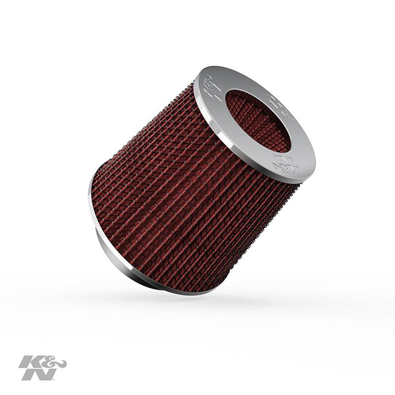

This is the K&N filter I'm running.... 4" inlet, 6" tall.

You'd think K&N would at least post the effective area of this filter in the specifications section! Grrrr...
Running the calculations using their formulas...
Assuming a 6000 rpm power peak, gives me a nice round 100 in^2. I'm probably below that, but I'll use that number for conservatism.
Based on their formula, and using a 5" average diameter, it's saying I need a 7" tall filter. But that doesn't take into account that my filter has additional filter element on the top. Also, I'm experiencing the restriction at WAY below 6000 rpm.
