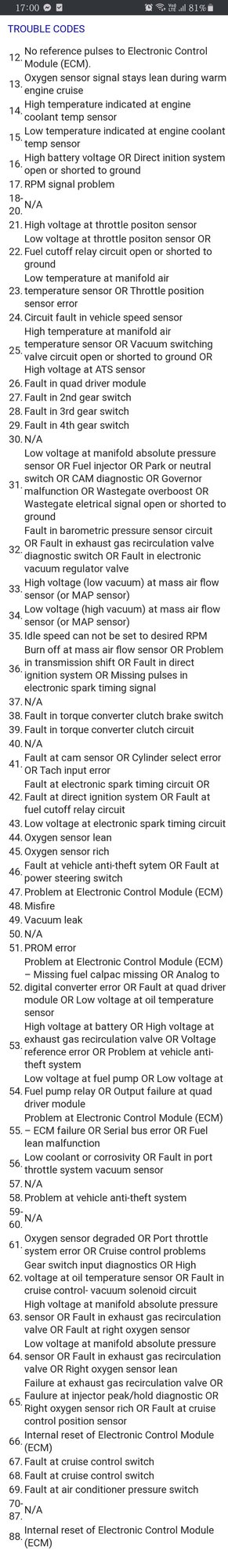

Have you tried checking the timing ?
I'd also check the base idle and you'll need a multimeter to check your tps voltage, it is pretty simple to check.
Also, the list I have a screenshot of from this site for engine error codes does not list a code 30.

The code 30 I got from a flimsy code reader. Do you have any recommendations for a better yet affordable scanner for this car.
