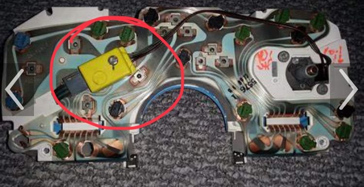

Re: 1986 Z28 305 TPI stalls when coming to a stop
If the cluster is missing then no Vss signal to the ecm
does it look like this ?

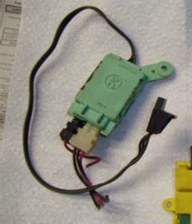

This would fix the lack of Vss signal to the ecm. Install at the transmission
https://tpiparts.net/inc/sdetail/7586
ground one wire and 2k ppm to ecm pin a10.
it looks similar, the one on mine is yellow and runs from the tachometer to the speedometer on the original cluster with the connector going onto the printed circuit board on the back of the gauges
Old May 30, 2021 | 08:35 PM
blakebrutality's Avatar
Joined: May 2021
Posts: 7
yes that is exactly what mine has
Must be like this , without a Vss signal the ecm won’t do lockup and won’t properly control iac on deceleration.
Your needs speedometer probably has a Vss but could be wrong ppm.
you can get a Dakota digital sgi-100bt to get ecm proper signal.
