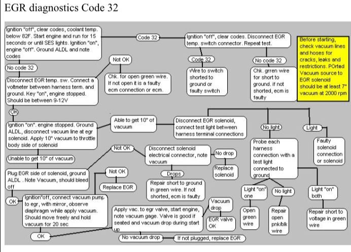

Hello everyone,
I report from the final steps of my rebuild journey... My 88 305 TPI.
I recently got my upgraded rear end back in, new brakes on all the way around, new goose neck gasket, new EGR solenoid, and new EGR temp switch, EGR was replaced around 1000 miles ago.
Imagine my surprise, when going to start my car, I find that I STILL have a code 32 after all these replacement parts (I thought for sure the switch or solenoid would do it)
I tested the valve to see if it held vacuum (It does) and to see if the diaphragm held (It did).
I am looking to have my new exhaust and cat installed next week, so right now I have a gutted (not me) open cat exhaust.
I read a few statements about not having enough back pressure from the exhaust.... I was wondering if that could be the issue? Or if there is something else I can check in the meantime.
The code pops up almost immediately after starting the car. Now I did replace all the hard line vacuum hoses I could access, it is possible I hooked up the hoses wrong to the solenoid.
Here are the parts I used to replace... Temp Switch and Solenoid
Which hose is supposed to hook up to the gold line? EGR or Vacuum?
Is this the right temp switch? I couldn't find any clarification if this was a normally open or closed unit.
I appreciate the help, I know this has been beaten to death before, I'm just looking for some inspiration or maybe something I missed.
Thanks!

Right temp switch, could always turn off the flag in the ecm

Did you verify if the egr was n or p backpressure when replacing?

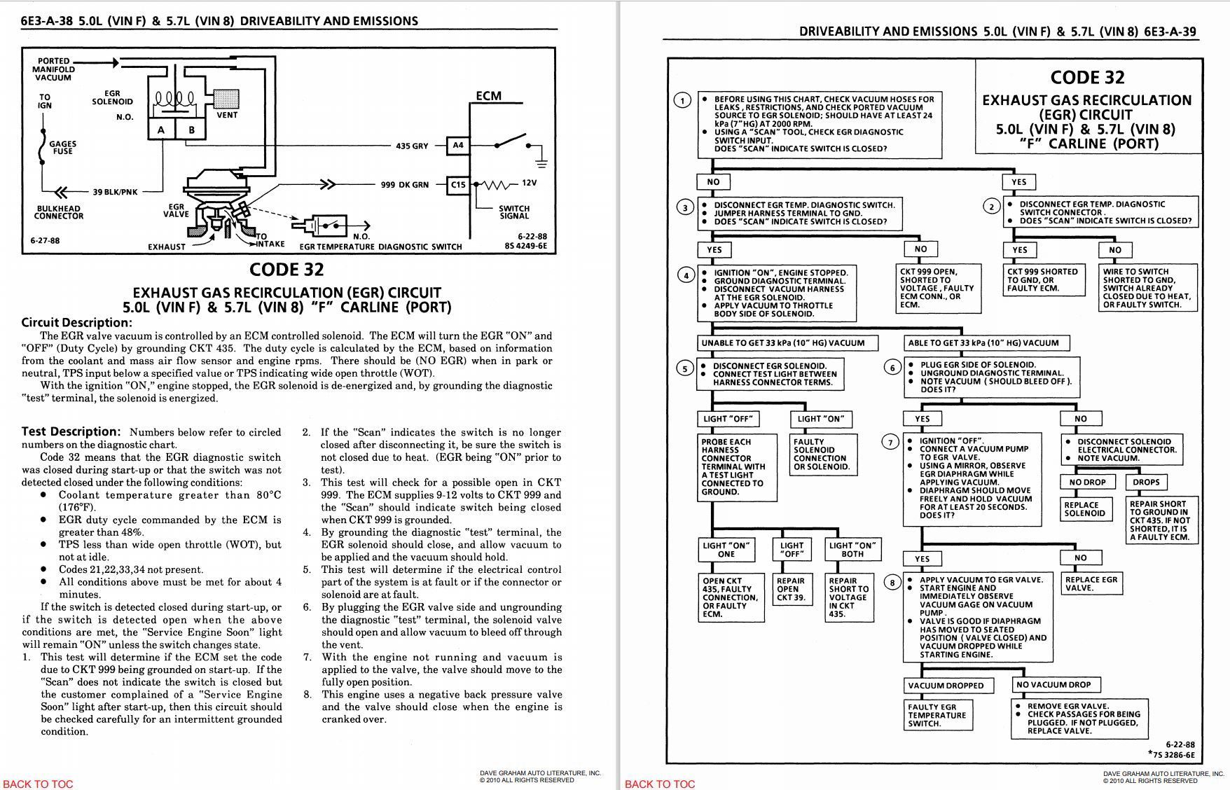

It is most likely that the engine was originally equipped with a negative backpressure EGR, and that would be indicated by the letter "N" being stamped in the vacuum servo cover on the EGR.
If the error code is generated shortly after the engine is started, I would suspect either the EGR solenoid or the EGR temperature switch is not presenting the correct resistance to the ECM outputs. The EGR function check would only occur after the ECM is in closed loop and vehicle is operate under conditions which would operate the EGR, or in other words, at part-throttle cruise. This requires a low load factor (LV8), engine RPM above 1,200, throttle position above 6%, park/neutral safety switch (or clutch switch) open, cruise brake switch closed, intake air above 1°, etc.

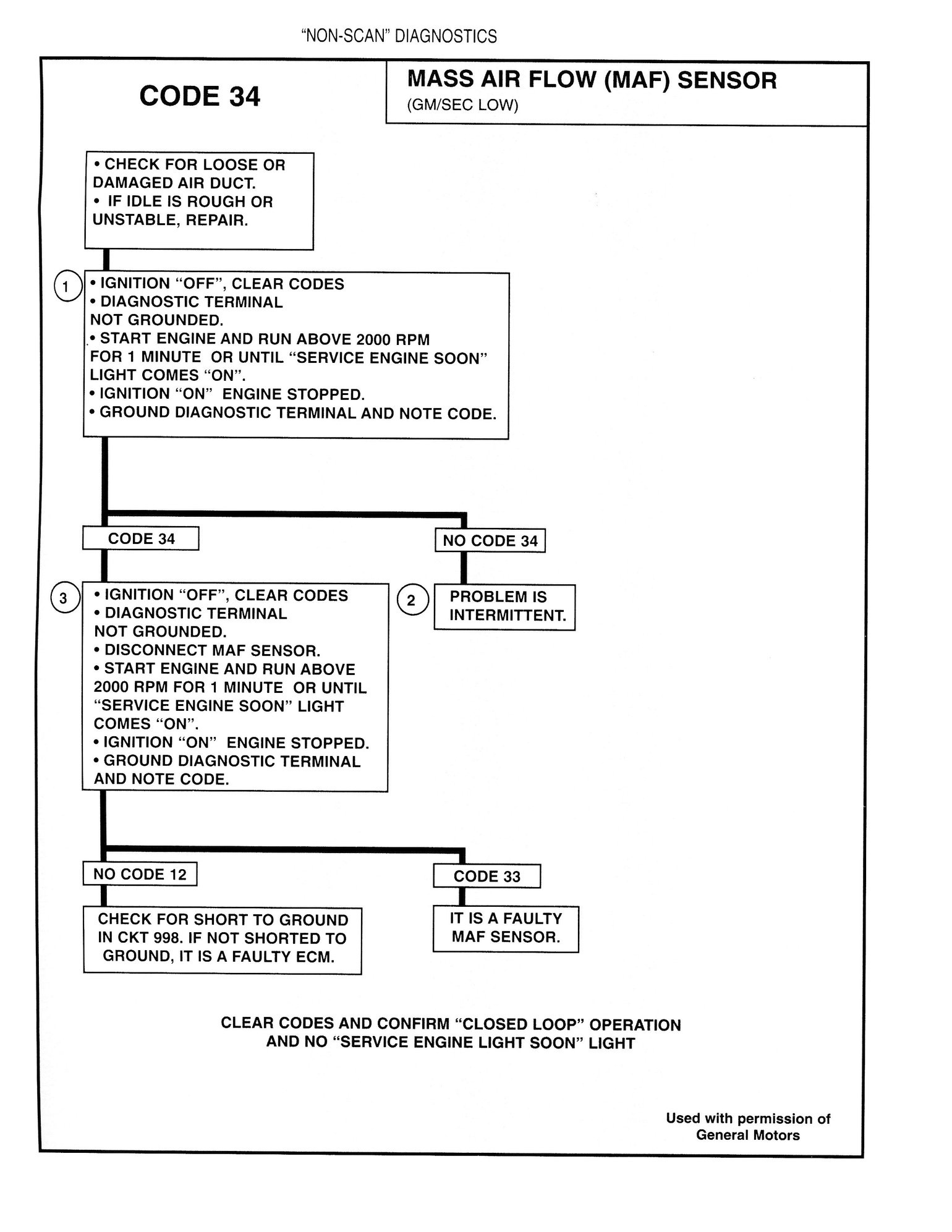

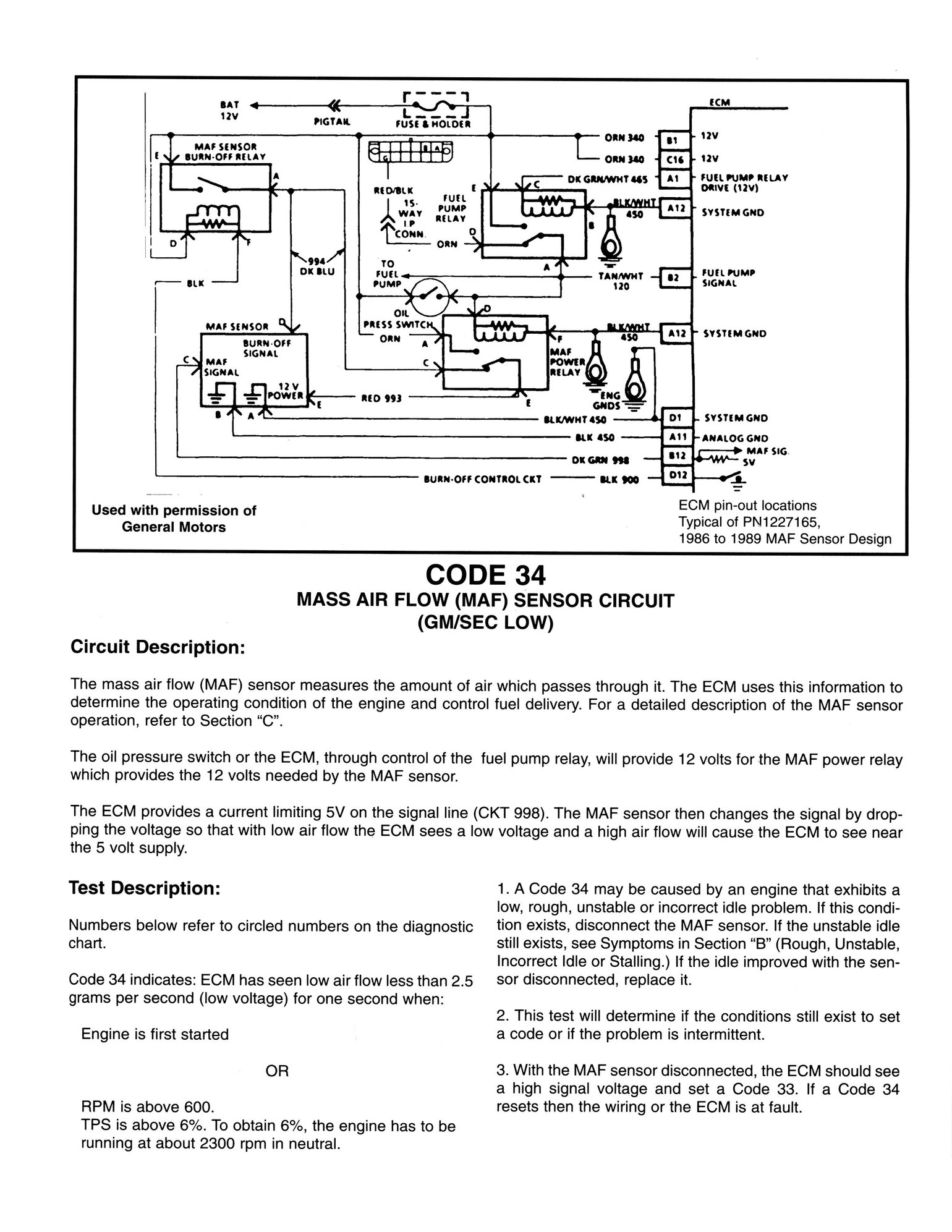

Could be faulty ecm or even a rip in bellows, wiring or maf even if new.
trouble shoot 33 & 34 with fsm trouble tree

Hmmm, thanks for this, the MAF seems to be functioning properly... At least, it seems to be reading data properly.
