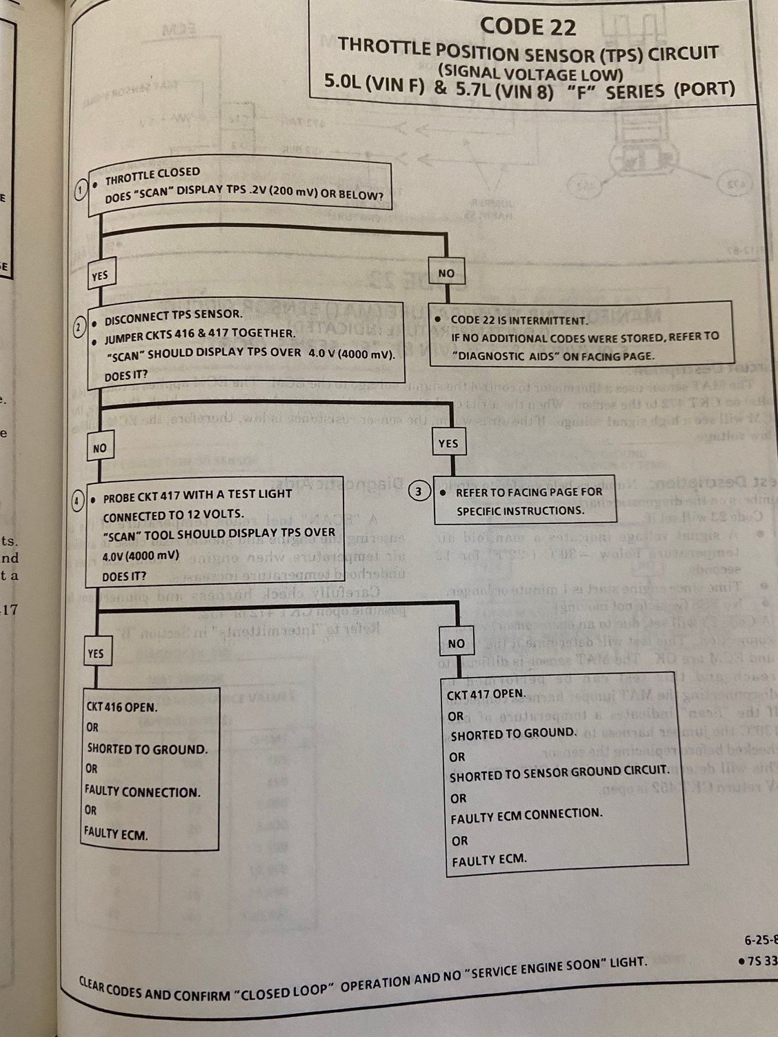

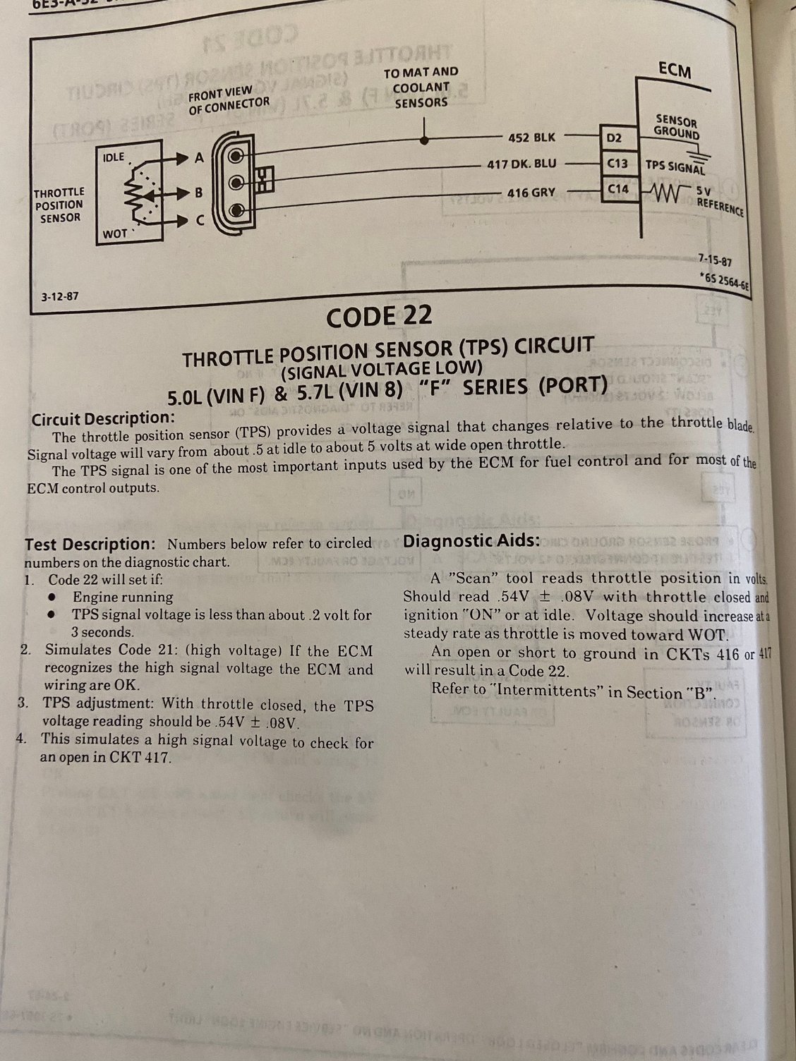

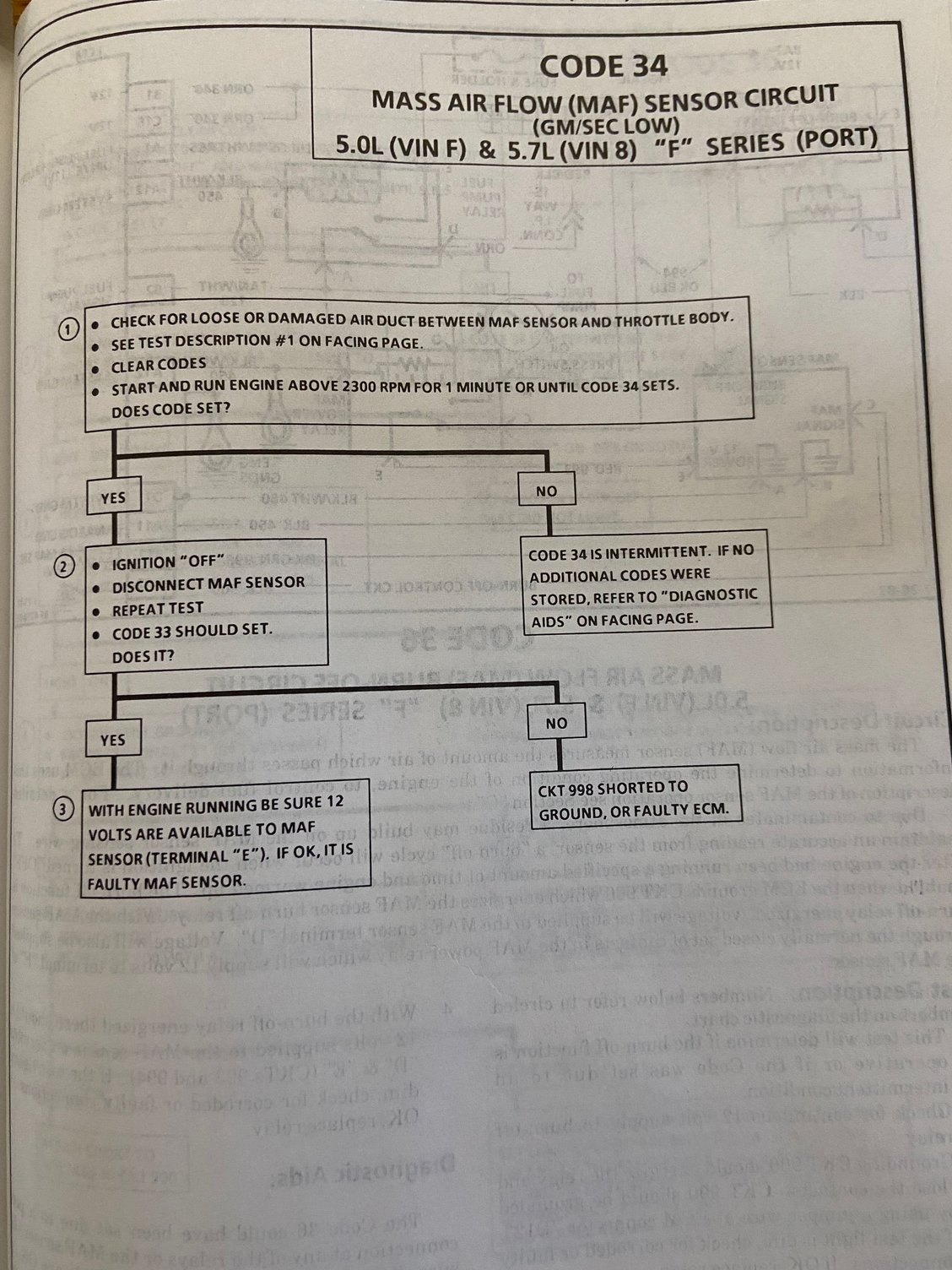

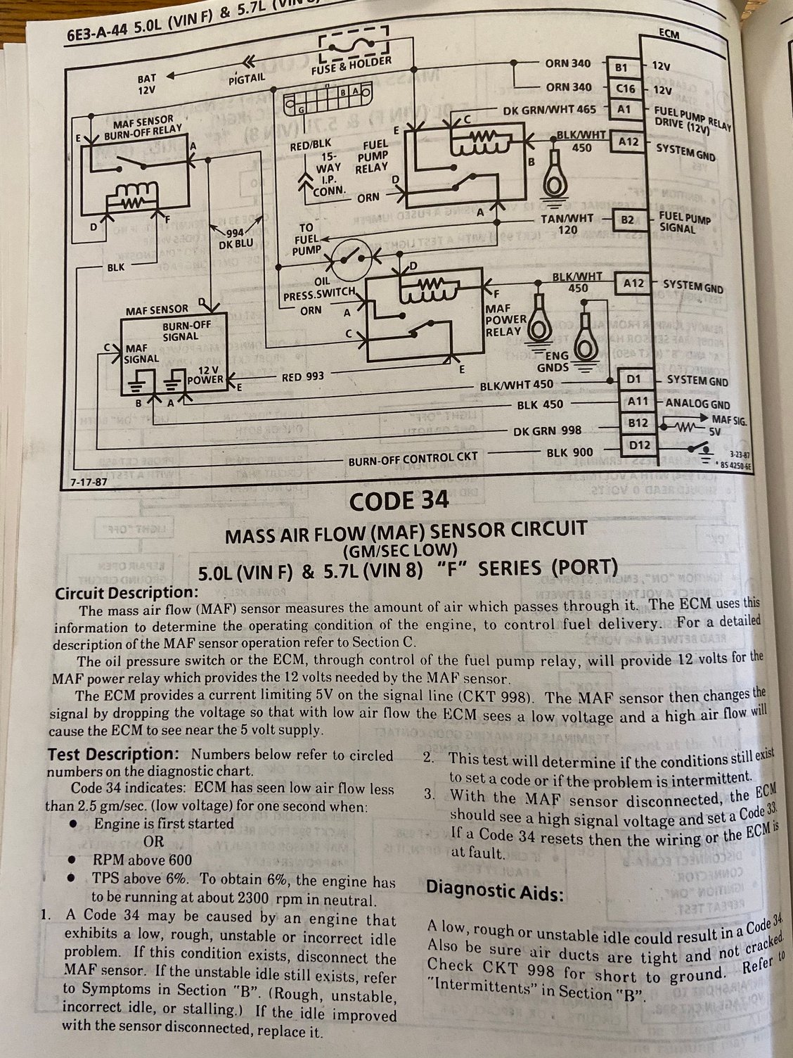

Is your car an 88’ TPI? I have some diagnostic trees from my 88’ FSM.
I would check your wiring for those sensors, connections and grounds especially near the rear cylinder heads , it does not sound like a fuel pump at all but you can verify with a fuel pressure gauge.
Also if it turns out the MAF is bad your best bet is a used Bosch which are tough to find good used or a brand new Delphi. Rockauto has the best price on the Delphi IIRC.

Thanks so much for the help! Ill run those diagnostics and see how it goes

Another test for the MAF is either disconnect it and if the car runs better with it disconnected it could mean the sensor is done.
Also with that TPS make sure that the voltage is nice and linear when opening and closing the throttle with your volt meter connected, if it jumps around or spikes while doing this the new sensor could be defective.
