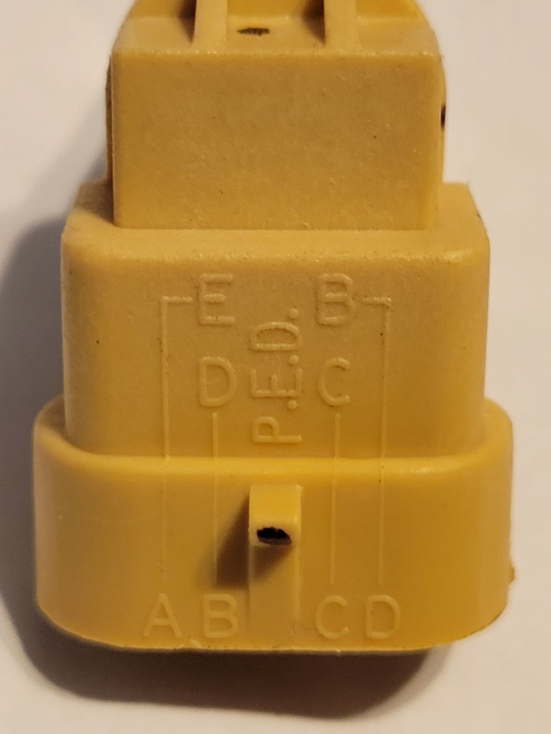

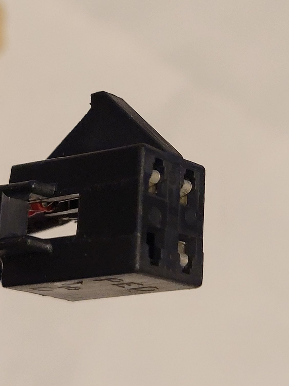

The outside bulkhead pinouts don't match the inside harness pinouts where both connect to each other......

did you ever figure this out? I'm having the SAME EXACT ISSUE. I was under the impression this was a plug and play harness/kit, nope. seems far from that. no instructions nobody has any THOROUGH write-ups as you can wire this thing up several ways.
I see everyone's pictures have the supplied 2-wire "in-tank wiring harness"
This is the only thread i've found where somebody is trying to use the supplied bulkhead connector and 3 wire harness, I am doing the exact same thing, no clue how I'm supposed to wire the fuel level sender in.
NO CLUE.
