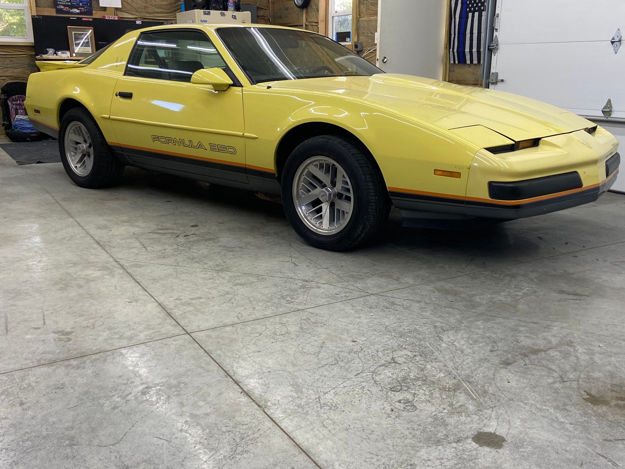

So I’ve recently acquired an 87 Formula with 48k miles on it. It won’t run unless I give it throttle and even then it shudders and spits. I was told it could be the injectors or mass air sensor but the injectors tested out at 16.6 ohms and the mass air tested out to be good. The distributor is corroded so I’m going to replace it along with cap, rotor and plugs but I feel it won’t change the idle situation. What could possibly be throwing everything out of sync so much that it doesn’t want to run?
My 87 Formula with 88 wheels.
