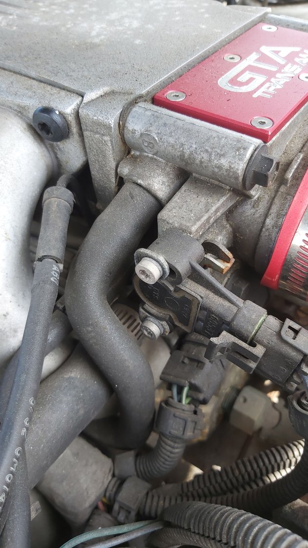

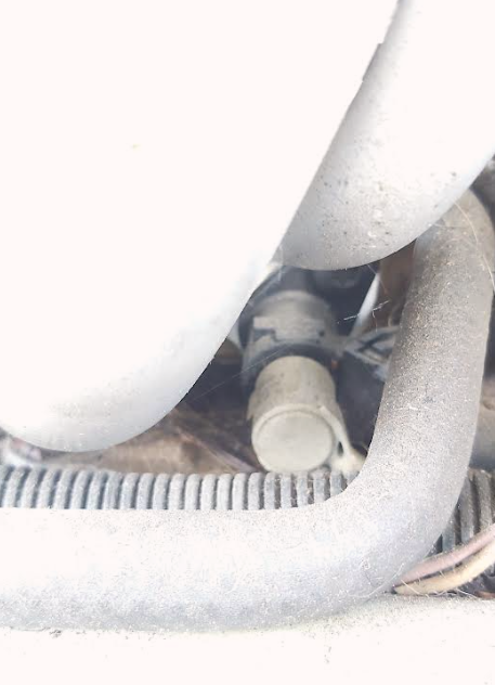

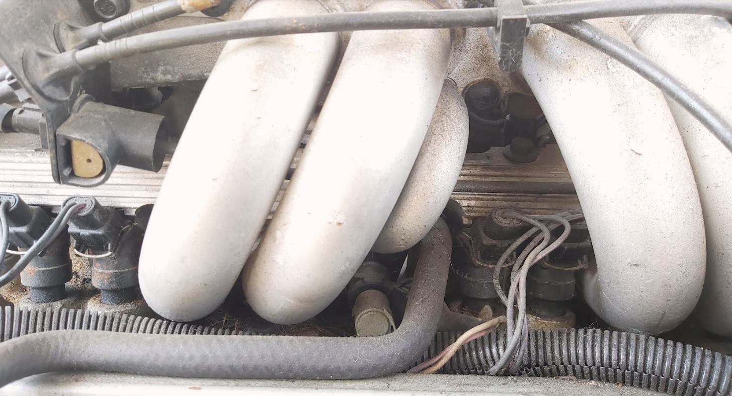

Bare with me on this, but is there a gauge that displays the fuel pressure? I have the stock digital dash. And I'm not sure where the cold start injector is located, but I am assuming around the TB. Is it any of these?

Ninth injector on the intake base between runners drivers side. To check fuel pressure there’s a port rear on top of rail passenger side. Was the car tuned for the cam ?

Looks like the injector is still connected. I will need to buy a fuel pressure gauge to check the pressure. I don't know if it was tuned when the cam was installed. That was all done by the guy the previous owner bought it from and unfortunately he passed years ago.
(Adding some pictures for reference for future members)

Was the evap hose disconnected from the tb just during the picture or is it always that way? It's a vacuum leak if the port isn't capped on the tb.
Might want to check the tps reading with a multimeter too. It's in a maxed out looking position which isn't very common.

I don't see a disconnected hose to the TB, would you be able to point it out in me picture (I must be missing it). I see what you mean about the TPS. I will check it with a multimeter. What should the reading be? 0.54? What would be the reason for someone to adjust it to the max position?

I looked at it goofy. The circled line looked like it was your evap hose. You're all good there.

https://www.thirdgen.org/tpimod2/
Reasons to max it out? No idea, maybe they thought it ran better instead of real tuning.

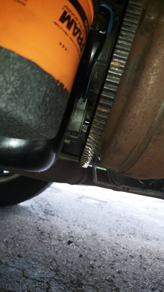

I was doing some work today and I noticed some of these teeth were ground up on the flywheel. You think this may be the cause?

If it cranks ok and not grinding then, no. That will prevent it from cranking fine. It'll grind and not make normal cranking sounds if it's a problem
