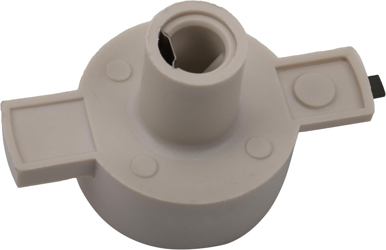

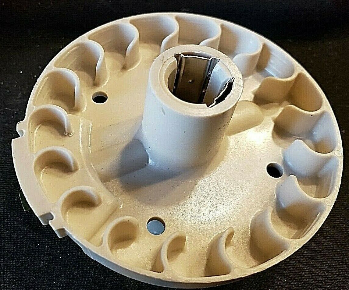

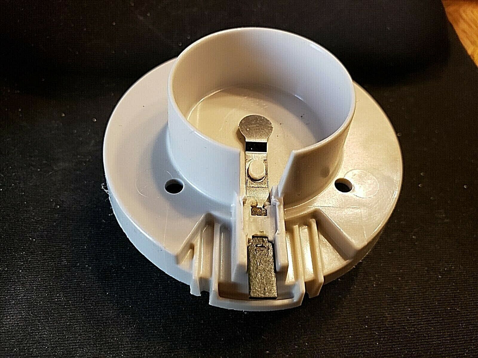

Much better small cap HEI rotor button used in marine, tall deck 366 & 427 engines, and industrial engines.
Made in USA. ACDelco D461, GM 10477219
Normal TBI/TPI rotor button.
Made in USA. ACDelco D447, GM ‎10496798
