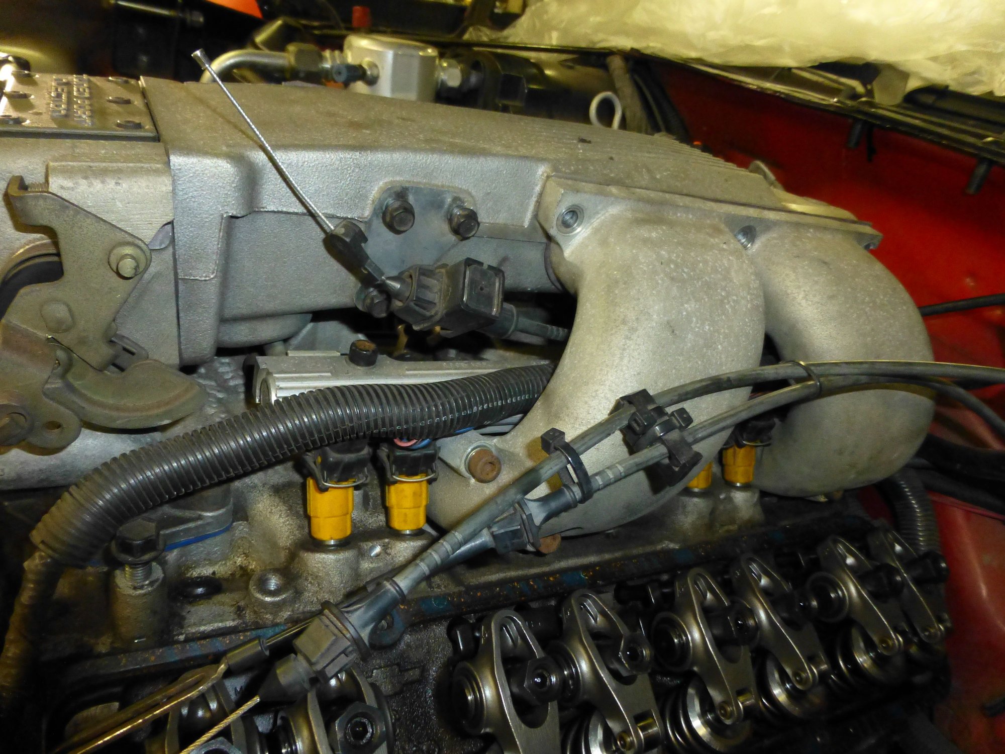

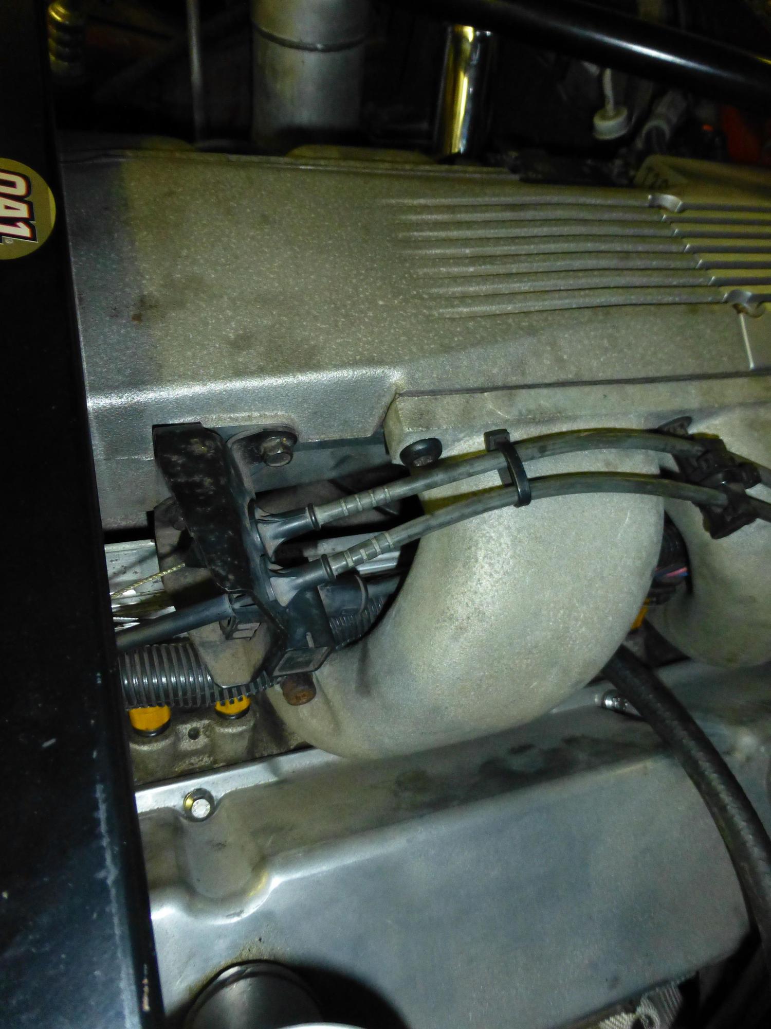

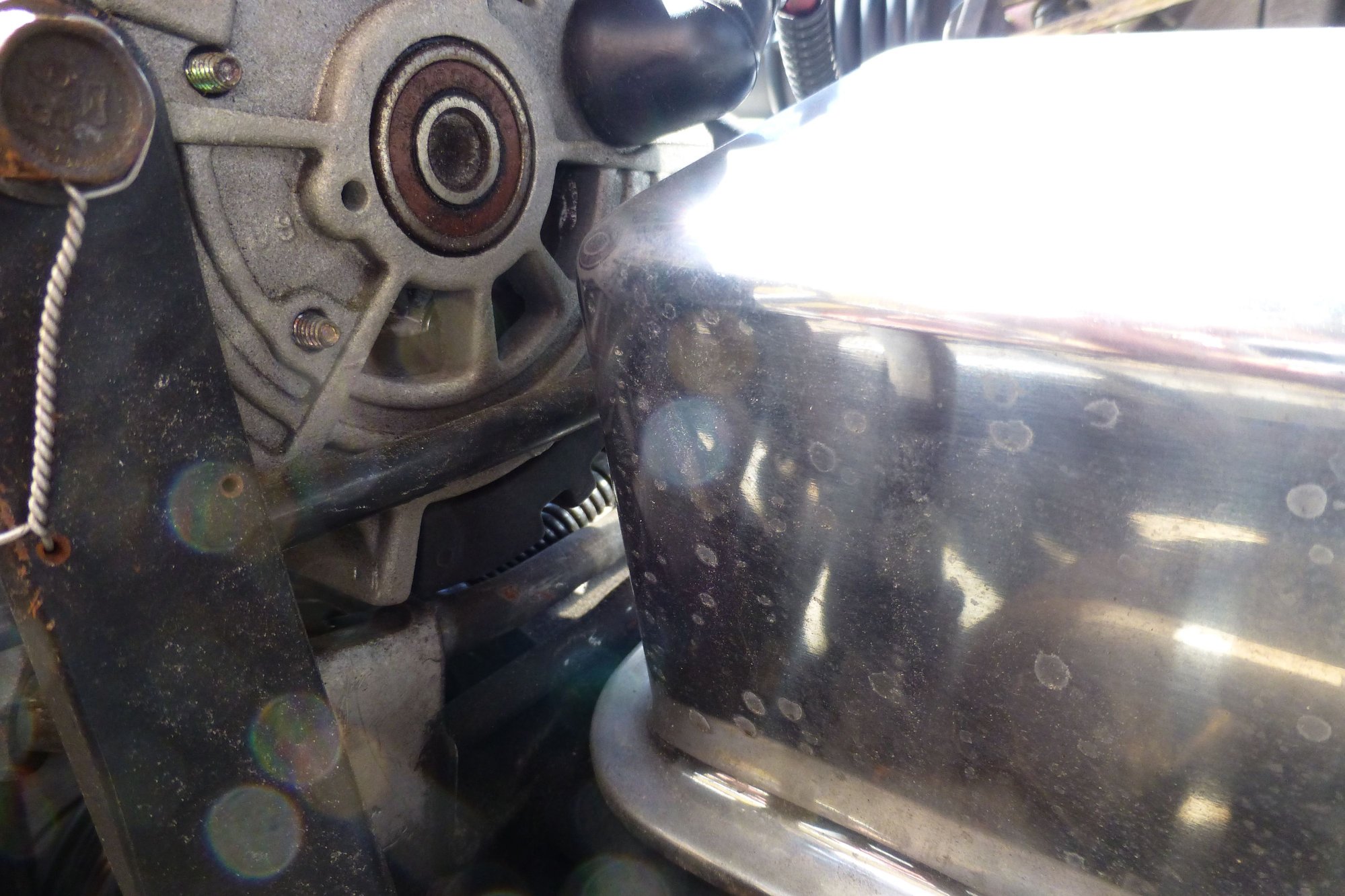

Re: L98 Rebuild- Next Steps- Roller Rockers-Valve covers
perimeter-bolt valve covers. had to rock the alternator over for some clearance to the power stud on the back of the alternator. serpentine belt drive.
