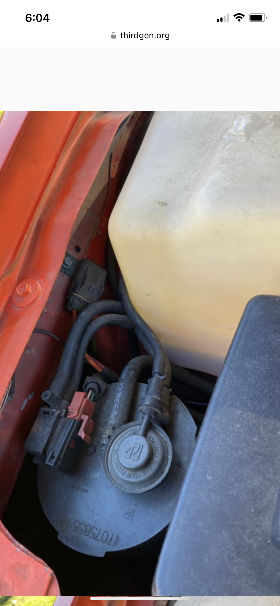

Sounds like the ecm isn’t powered up. The fuse for pump/ecm is in a plastic holder on the fender.

that’s the first thing I looked for. I found one on the driver side close to the radiator in a fuse holder. But not near the battery like everyone says it should be.

Look by the charcoal canister
