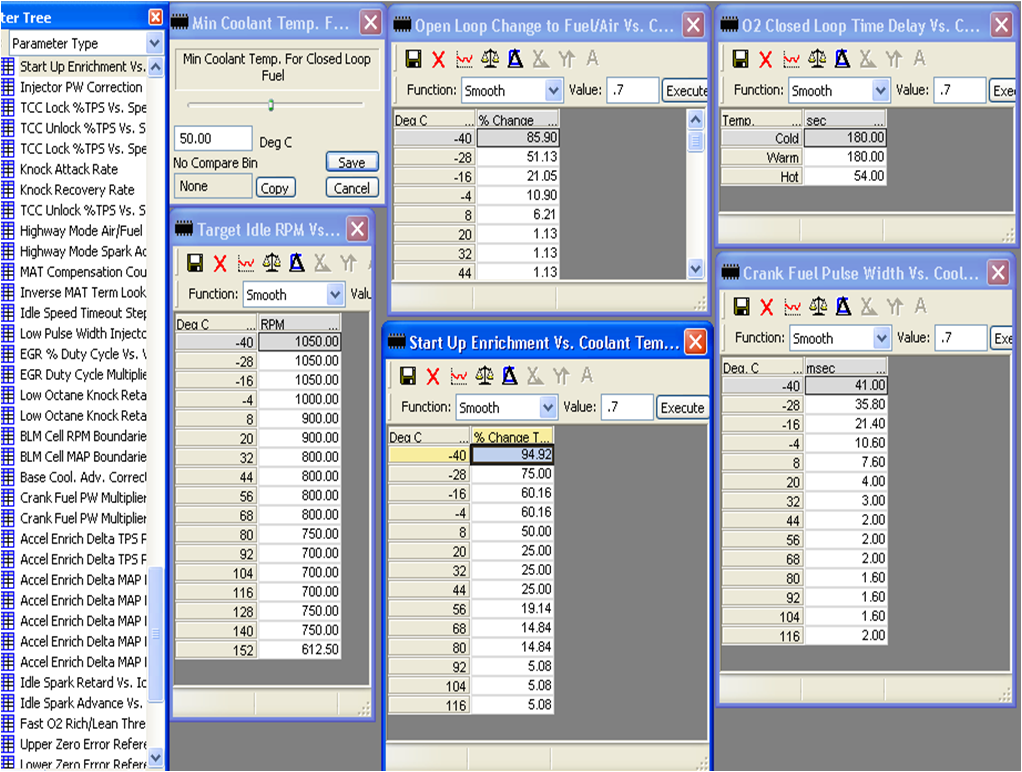

Here's some items that are influenced by the CTS...keep in mind that some of these are only added during crank. I would've posted down below but I wanted to keep the C to F chart near by so you don't need calculate it.
