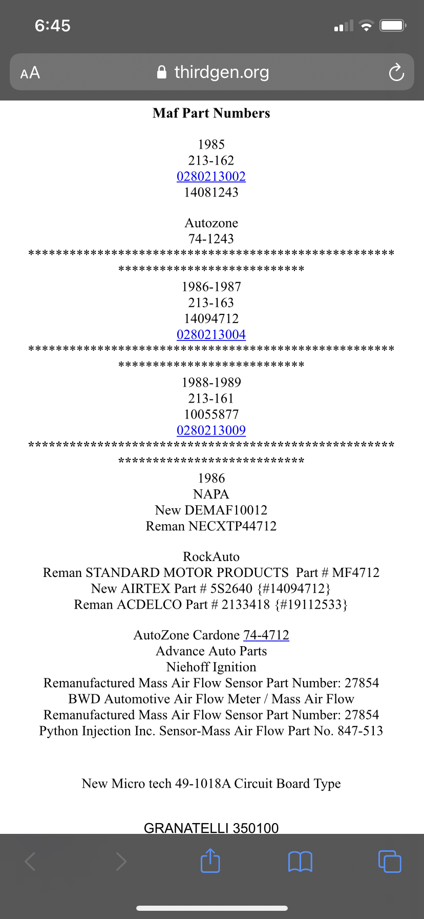

Old Sep 3, 2023 | 12:07 AM
Reddragon88gta's Avatar
Joined: Apr 2017
Posts: 1,149
Likes: 445
From: Northern NY
Engine: 5.7 L98
Re: best MAF sensor for 1989 firebird 5.7
Here it is:
