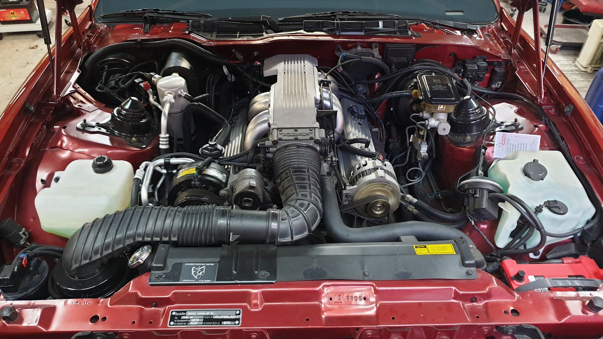

Here are a couple pics of mine. It was all removed before I purchased the car but I probably would have gotten rid of it myself.

That's a beautiful engine compartment. What did you do with the tube going to the CATs ?

I removed it when I refinished the valve covers. Funny you mention that as it was the only AIR part left by the previous owner. IIRC there is a metal clip with a bolt to the firewall that holds the tube in place. You have to remove it from underneath. The tube was just cut off @ the cat. Then I pulled everything up through the top. My check valve was still attached so it won't go out the bottom.

Did you use pipe plugs on the exhaust manifolds ?

Yes I did. I can't remember what the threads were but I got them @ my local ACE in the plumbing section so they are nothing special. I did paint them black before I installed them.

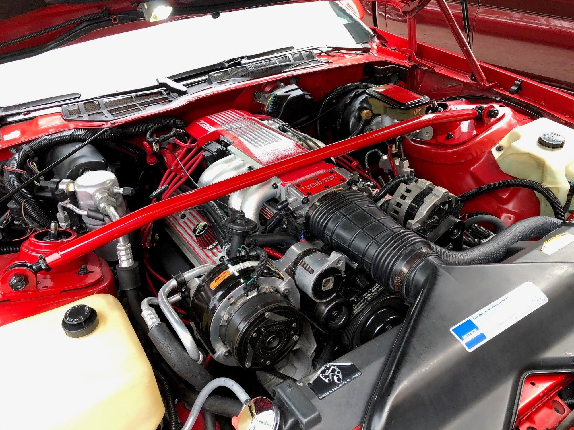

My 88 L98, AIR 100% deleted.
My 92 LB9, AIR 100% removed but a little modded engine bay.

@@J.C. Denton Nice, clean engine compartments.
Pardon my ignorance, but what is the significance of the headlight decal with "1.25%" affixed to the radiator support?

That's a german thing. This is the base setting for the headlight adjusting device. It's needed for garages or our every two year technical inspection we have to pass by law. You may also notice the black metal tag beneath this sticker. It is also recommended for us here. Don't ask me why, I've given up asking myself about stupid law requirements years ago.
