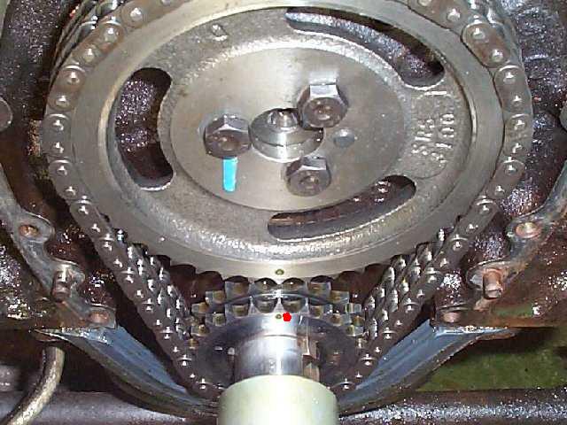

Since the timing set gears are at a 2:1 ratio, the crank needs to rotate 2 full revolutions in order for the camshaft/distributor to complete 1 full rotation hence you could be 180 out.
You could possibly rotate the engine until the mark on the balancer is at TDC then remove the distributor cap to see which plug wire the rotor is pointing at. Once you establish that it's pointing at 1 or 6, you can do 1 of 2 things...pull the distributor, rotate crank 1 full revolution aligning the balancer with TDC and re-stab distributor at 1 or 6 depending on which cylinder you started with or pull the distributor just enough that the distributor gear disengages with the camshaft gear allowing rotor to turn freely and then attempt to re-stab it rotor pointing at the opposite cylinder.

Wow. That photo has really made the rounds in the last 20+ years. I guess it's worth more than a thousand words, as they say.
You might as well show the "before" photo of the twin bicycle chain timing set:

The point of that is that the distributor could be 180° (360° crank rotation) out of phase, or could be just a tooth or two off, resulting in 30-70° out of the intended position.
