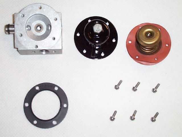

Been researching these on here but a lot of the posts are more than a decade old. Saw a lot of slamming the Holley ones but that's 2007. Is there a preferred one? I have a piece of junk from way back and I can't get it below 50psi with a racetronix pump. There's also BBK which doesn't seem like a favourite either. The screw is a royal PIA to access, I get that, but it's a once and done operation so the extra expense on the ease of the Holley doesn't make a lot of sense to me.

I run the Holley and really like it, it is a more compact design that does not have the nut on the top for adjustment but a flat dial that you can adjust with your hands, no tools required. It is more money than others but seems really well built.

I have 350 TPI in my 87 Monte Carlo SS. I used the Holley AFPR about 5 years ago. The problem I had was the diaphragm failed after a few days, dumping fuel into the vacuum line. That was a common problem with those units back them. I hope that Holley has improved over the years. I currently used the AFPR from SouthBay.

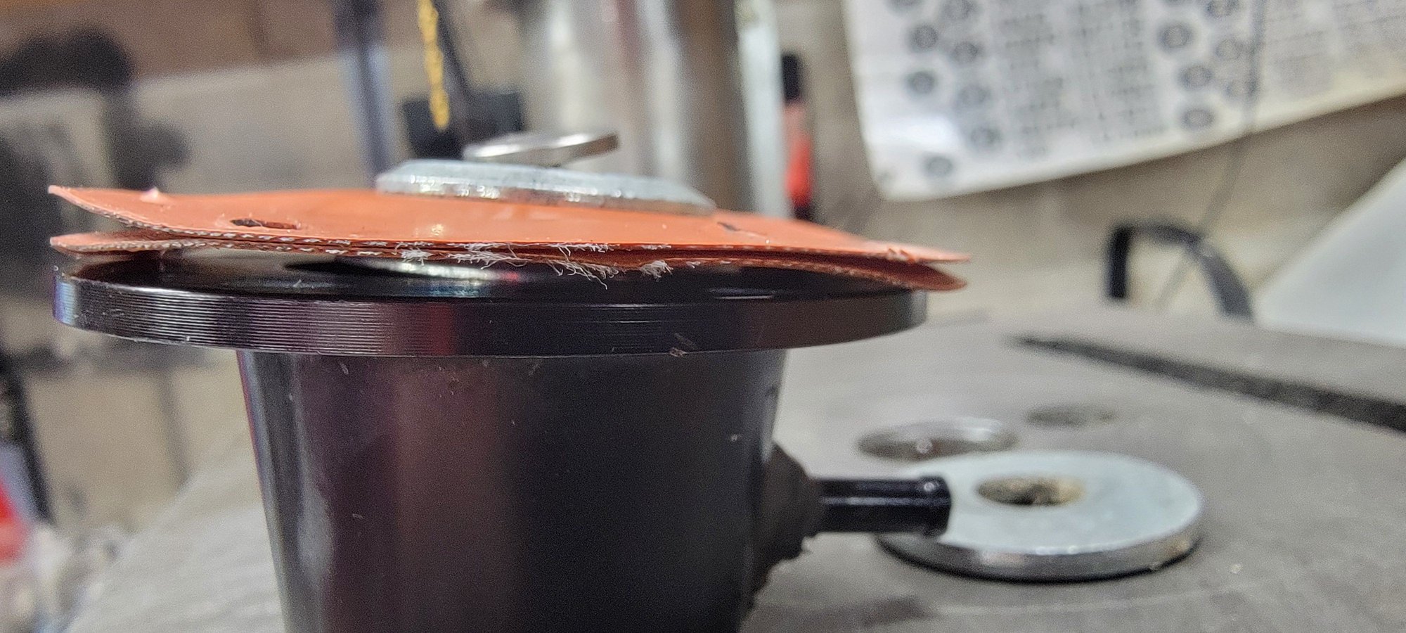

So reason I was asking about AFPRs was I think I have an issue with mine. After @SbFormula laboriously and quite graciously and effectively helped me tune my car, I discovered a fuel pressure anomaly once I installed an AEM digital gauge. It's running at 43 psi vacuum connected. When I unplug it it goes to 50psi. With the screw fully out it won't go below 50psi. Then when I crack the throttle or hold it for a couple seconds at a higher RPM, the fuel pressure drops to around 37 psi. So I'm wondering now if there's an issue with that diaphragm.

I wonder if the disc
that comes with the regulator is to thick, or if the regulator housing is to short. In the pics I've enclosed, one is with the disc one without. With it the regulator sits pretty proud. That's with the screw removed as well. The disc is 1/8" thick.
