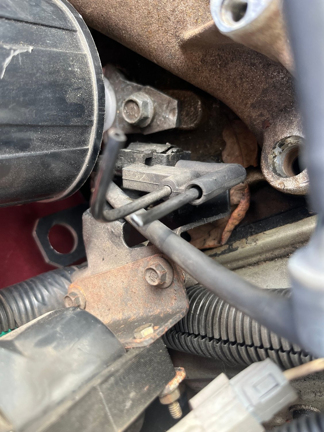

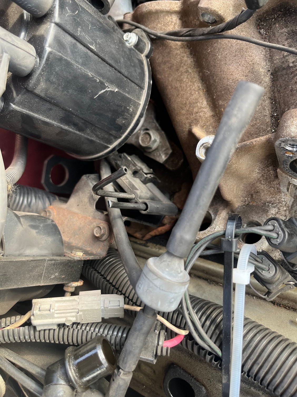

My 1988 Camaro has some broken hard lines, one goes to the t connection for the canister and I don't know where the other goes. Does anyone have any photos as to how theirs is routed and and any ideas how to replace them and where to find replacement lines

EGR and throttlebody

Yep... The other one goes to operate the EGR valve... That thing mounted next to the distributor the tubes connect to is the EGR solenoid switch....

You'll never find that EGR solenoid. Gotta go with the Corvette setup.
