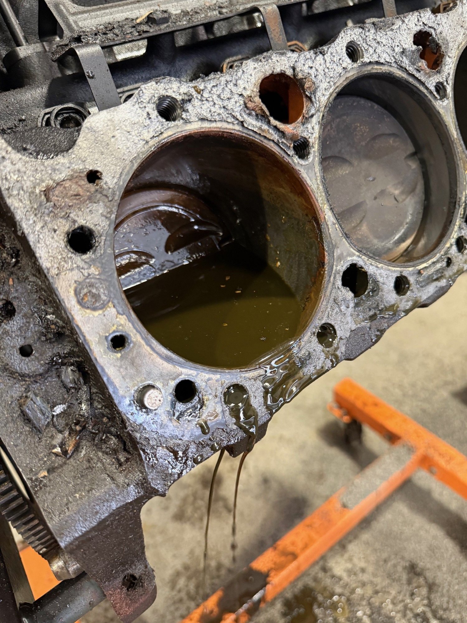

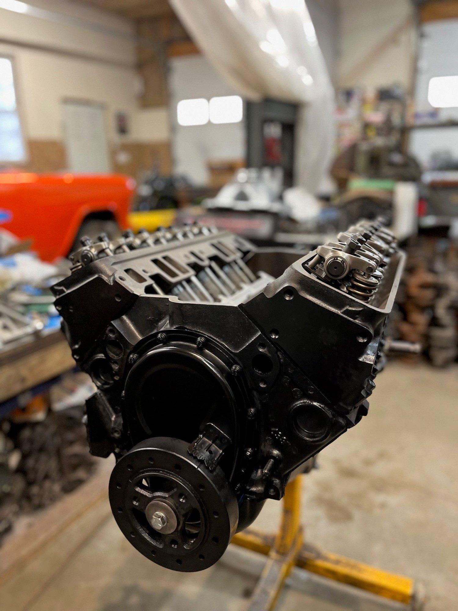

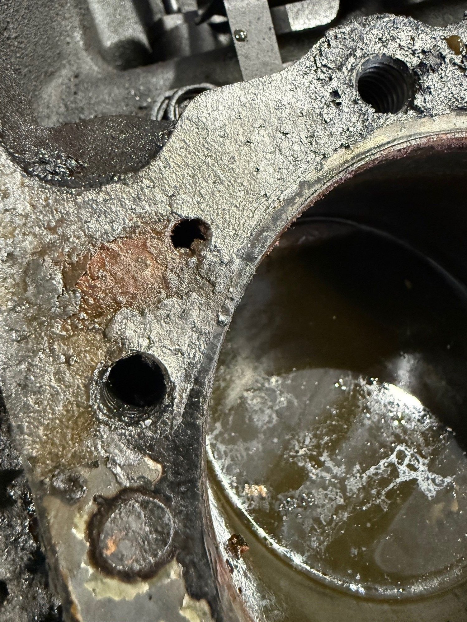

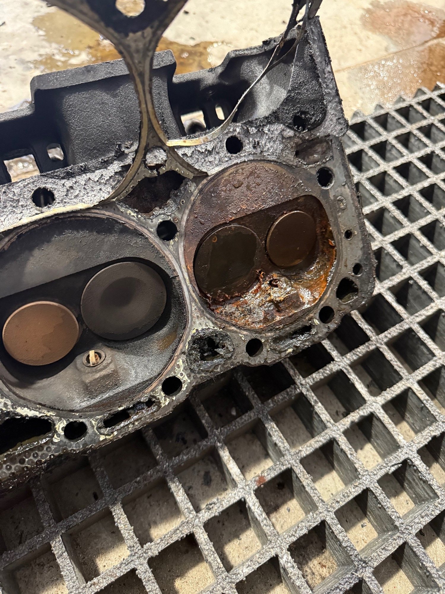

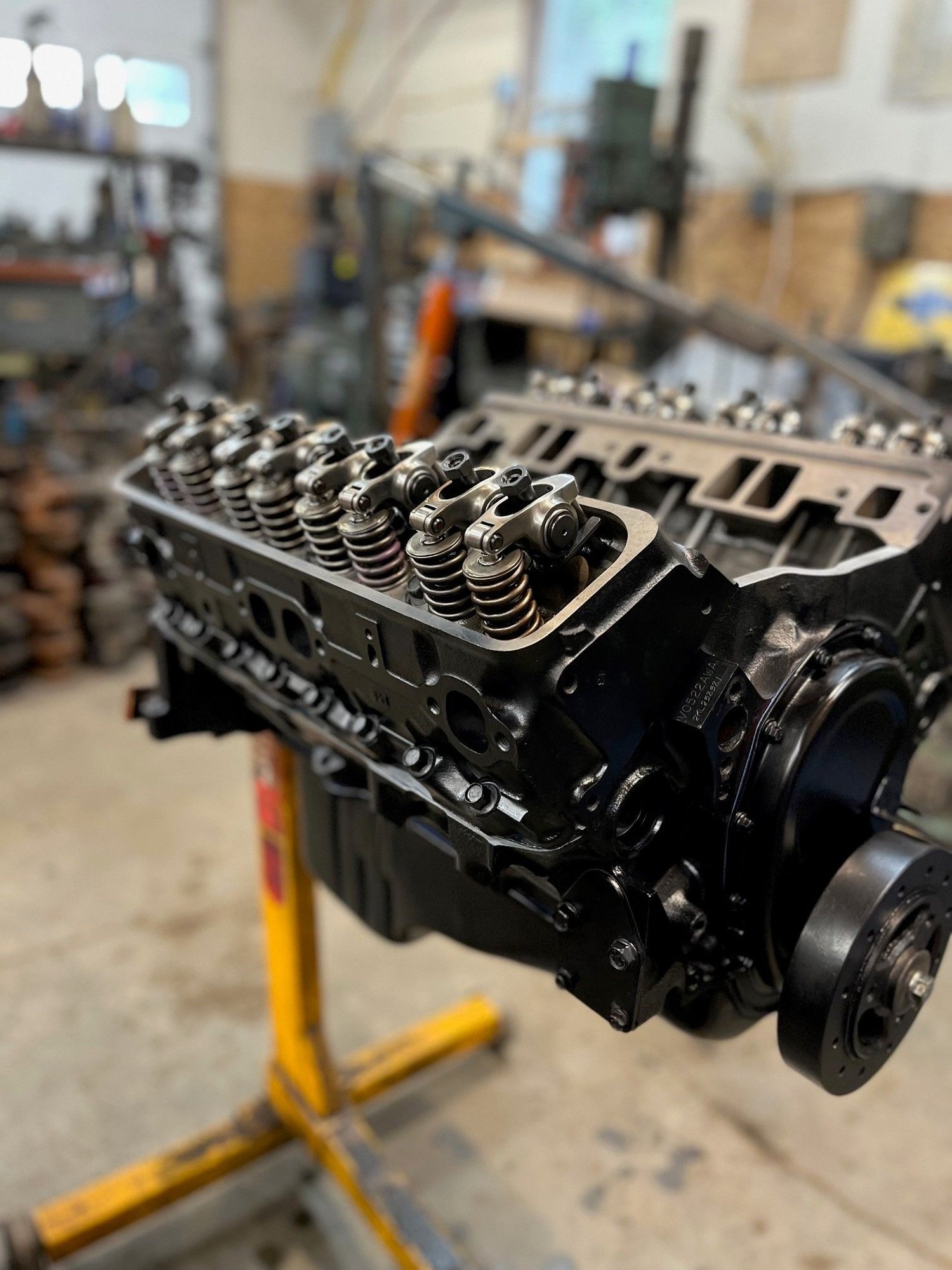

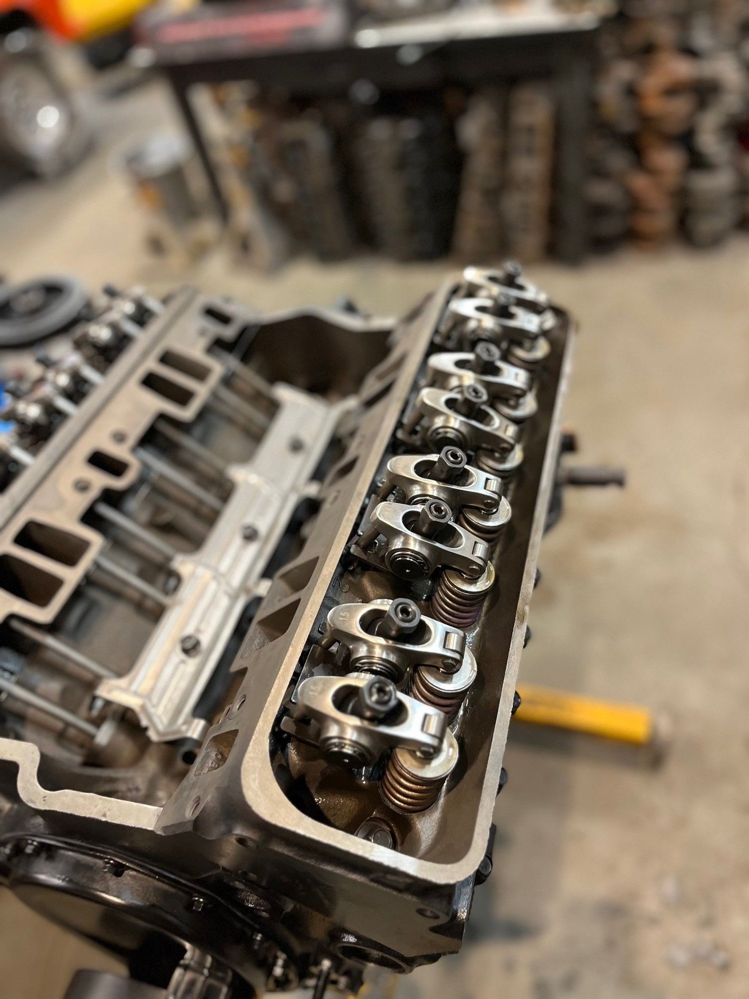

Turns out it was the original/matching block so I broke the motor down and found the culprit. Looks like a bad head-gasket and water in the cylinder. I was able to find a reasonable motor builder in NH who rebuilt it and put the ZZ4 cam in it. I just got it back Monday. I'm going to have the transmission done as well since it came out with the motor. Now its getting exciting

Looks good! What valve covers are you going to use to fit over the rockers?
Old Apr 22, 2025 | 02:52 PM
TransamGTA350's Avatar
Joined: Apr 2000
Posts: 1,536
Likes: 322
From: South Windsor, CT
Car: '89 GTA
Engine: ZZ6TPI
Re: 89 GTA crate shortblock?
A bad head gasket is what took mine out as well.
Yes, looks good and should run well.
As TTop350 said, those rocker arms may not fit under the stock valve covers. Do a test fit, but might need a taller cover.
Old Apr 22, 2025 | 05:59 PM

Originally Posted by TTOP350
Looks good! What valve covers are you going to use to fitbover the rockers?
I was wondering that as well. I was going to try and grab a pair of the magnesium C4 covers bc I like the look but any recommendations? I really don't like the stamped steel look
Old Apr 22, 2025 | 08:35 PM
TTOP350's Avatar
Posts: 12,231
Likes: 1,158
From: Il
Engine: 4++,350 & 305 CIs
The valvecover webbing and air oil separator wont fit with those rockers without mods.
the vette covers will need some milling for clearance,
the stamped steel will need some webbing cut out.
a narrow body rocker would make it easy.
ive used the comp rocker like those and had to modify my covers big time.

The pro form/zz6 covers work well on my heads w roller rockers.

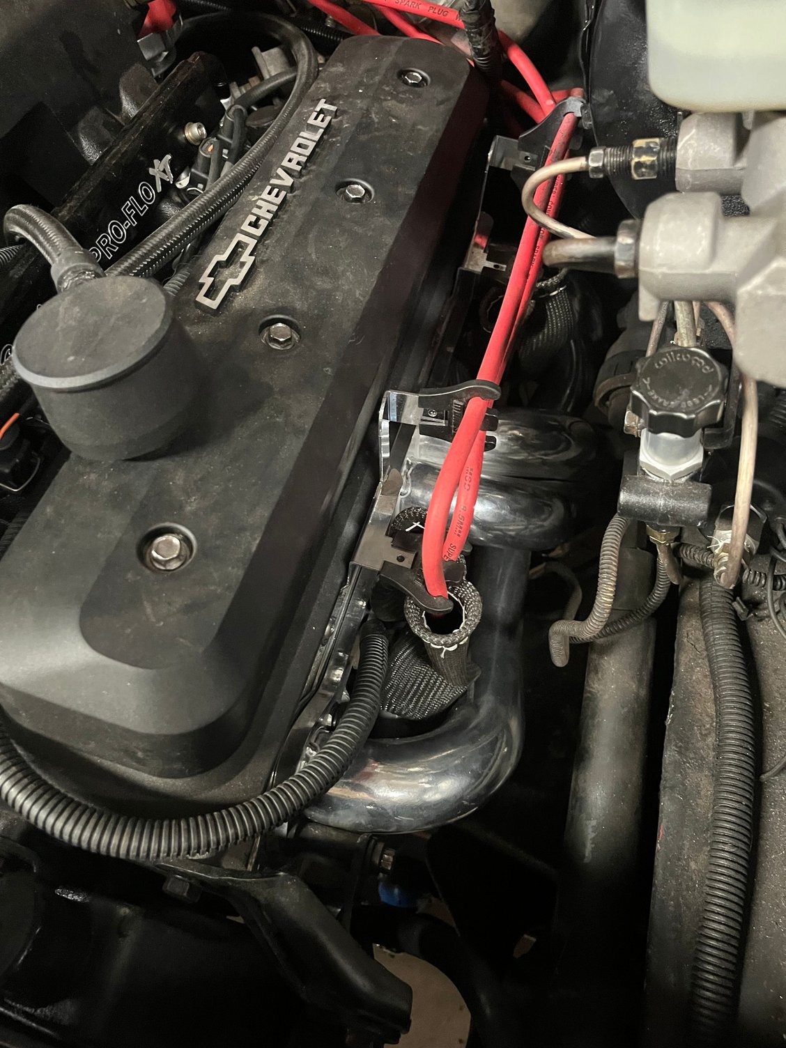

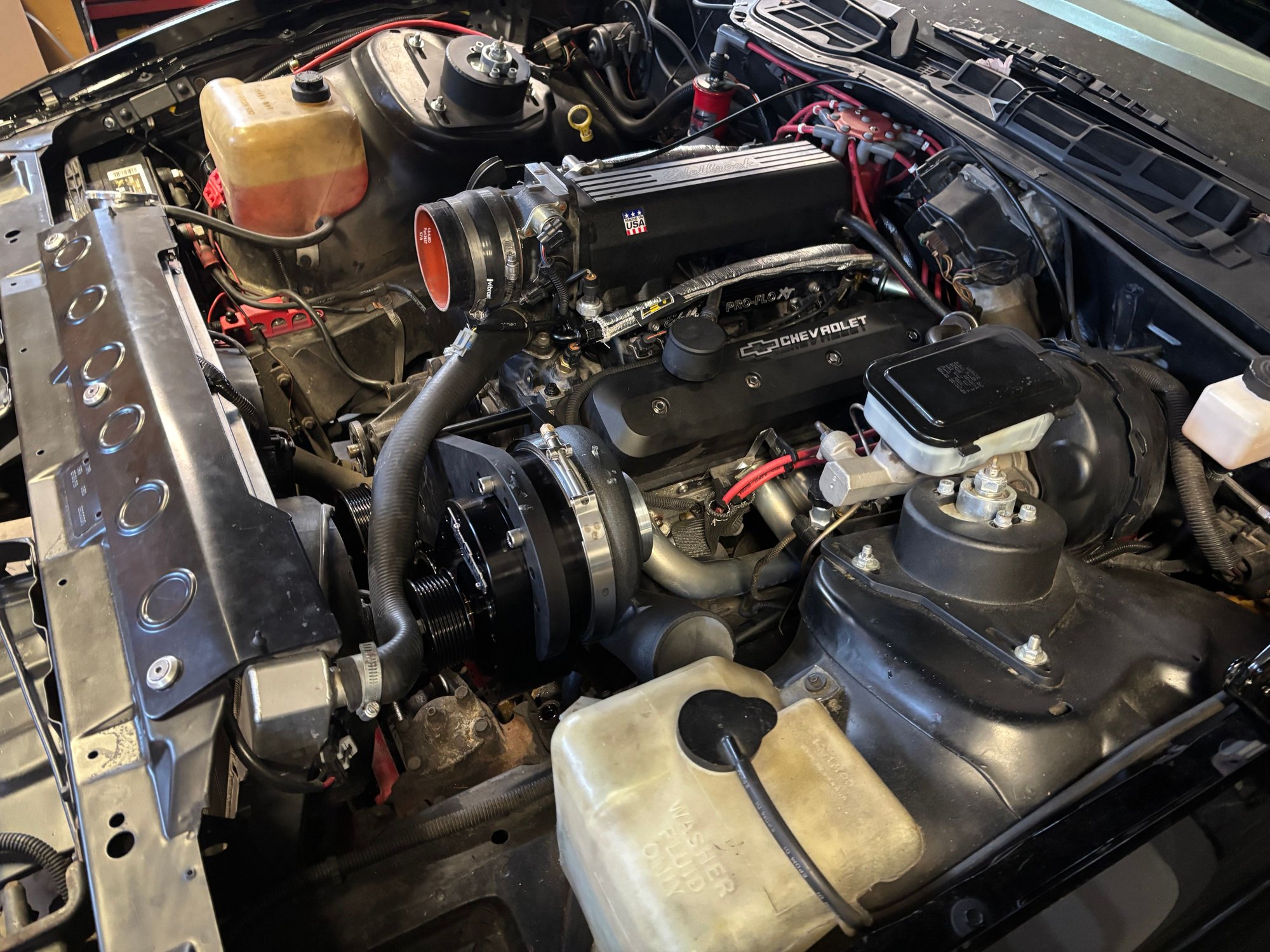

This is what I ended up going with and holly **** did these valve covers make things difficult on that side of the engine, but I love the look. Now I'm dealing with a alternator clearance issue; this is my last hurdle!! Now fabbing offset brackets to overcome....awwwwww!
I ended up painting a lot of parts silver to make the car look very 80s with a hue of transformer vibe ( i.e. Autobot) almost as if there an alternative factory look.
I think it pairs well with the gold wheels

That looks great. Yeah, those valve covers look tight in there. They look cool.
