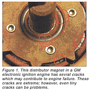

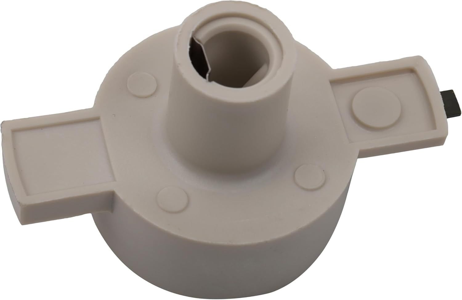

I see in more than one thread you have that you have replaced the sparkplugs, sparkplug wires, and air filter. But no mention of the distributor cap and rotor button. Have you replaced these or took the cap off and looked inside yet?
After watching your video there is a slim to almost 0% chance this is causing your idle speed hunting issue. But it for sure should be looked at.
I removed the distributor cap off my friend's 27k mile 1 owner 1990 Formula 350 that you could eat off of top to bottom, inside and out and underneath, and the inside of the distributor looked like it had been recovered from the bottom of the ocean right next to the Titanic. A huge heaping handful of white fluffy corrosion mixed in with green corrosion and rusty AF inside.
The original assembly line installed Delco-Remy distributor cap and rotor button were ate the f*ck up with just 27k miles on them. The distributors for our cars are poorly designed due to the fact they have no "good" way to vent the ozone and moisture out of the distributor cap. They have two fine mesh screens on the bottom of the distributor to vent the ozone and moisture out of the distributor cap but most of the time they are clogged up and never did work worth a damn to begin with anyways. The cap itself should have been vented.
There is an improved rotor button for our distributors that greatly helps with this problem that was used on marine and HD applications.
ACDelco D461 GM Original Equipment Ignition Distributor Rotor Button.
This is the improved marine and HD rotor button that came in the distributors for those applications.
ACDelco GM Original Equipment D447 Ignition Distributor Rotor Button.
This is the crap rotor button that came in the distributors on our cars.
GM Small Cap HEI Distributor Magnet Cracks.
I haven't forgotten about my post above concerning the IAC and TPS. I been busy doing other things and I'm lazy. I'll get back to it.
