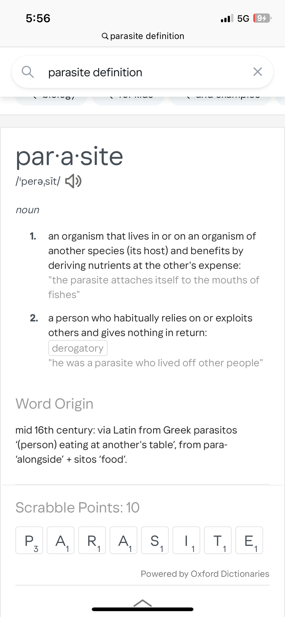

parasitic draw !

Re: IAC memory?
Originally Posted by Adam1989
Yep, that's what I've always known as a draw on the battery.
