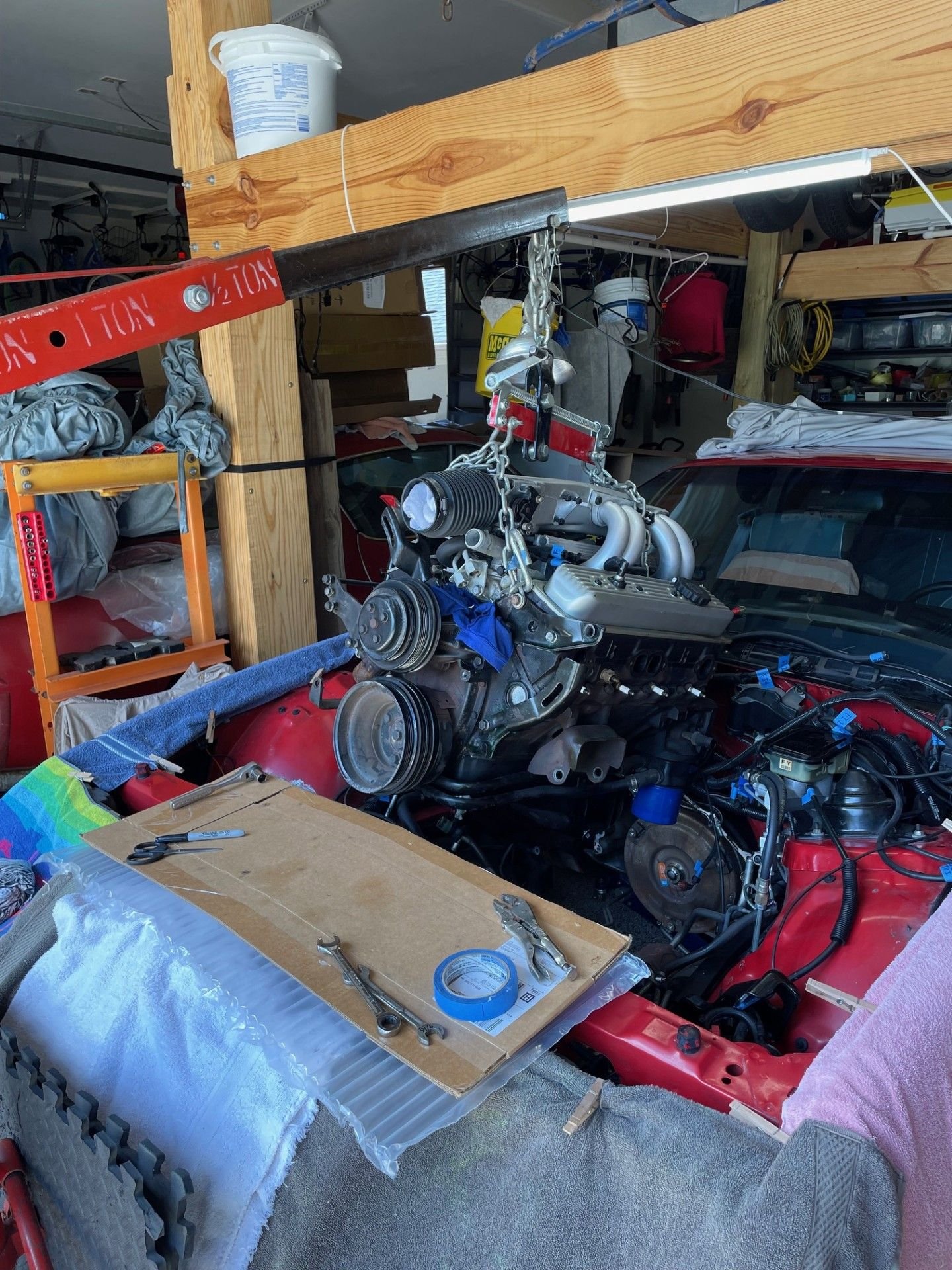

350 TPI engine coming out in May 2025.  If you look closely in the engine bay, you can see all the blue tape labels of where all the wiring harness connectors go.  I'm pretty **** about stuff like that.

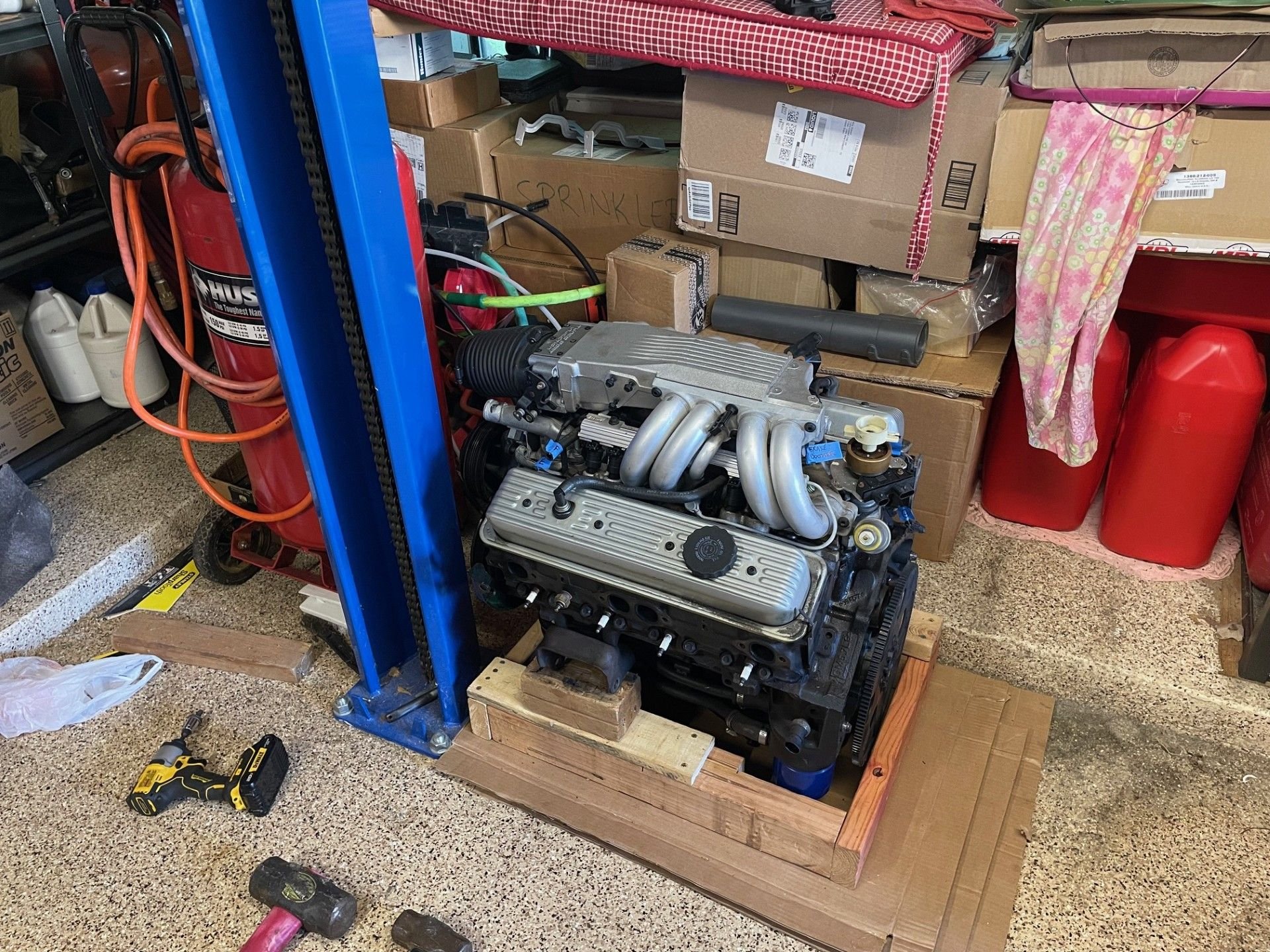

Here it is just waiting to be put back into service some time in the future.  Maybe.  Anyway, the engine is covered now.
