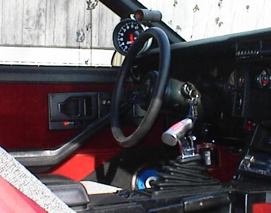

Oh, manually shifting, I would be very careful I wiped the cam in my 305 manually shifting, went to shift to D and slid into N at WOT, that's why I have this. An aftermarket shifter will be very useful and safer.

Alright. I already invested in the same shifter you have, so I shouldn't have any problems with going through a gear accidentally, etc. I just had my car out again, trying to figure out the various speeds that it shifts while in D and OD. I readjusted the TV cable again before I left just to make sure everything was OK. It seems like the 1-2 shift is about 10 mph, the 2-3 shift is about 25-30 mph, the torque converter lock/unlock is around 45 mph, and the 3-4 shift is around 50-55 mph. If I were shifting manually, would I have to wait until I reached these approximate speeds until the car would shift once I moved the shifter? The reason I ask is that I shifted from first to second at about 20 mph and the tranny didn't seem like it shifted at all.
