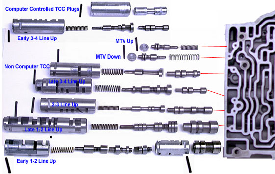

Hey, I see a gm "repair kit" in that top photo. looking at that valve body where is the 3-4 shift? I'm trying to figure this kit out and I have my valve body out. Where do the other parts go? Help please...there is lots of talk on here from searching, but no clear answers!

The GM valve in the photo is the 3-4 shift valve, sleeve, & spring.

Yep, I know that...which one does it replace? There are 4 of these in a row for different shifts and I don't know which one is which! When looking at this picture from the top of the valve body which one is the 3-4 shift? Also I replaced the regulator pieces and there isn't any play after the snap ring is in. Is that normal? It seems that I could push it up and down a little before I originally took it out. I wish someone would put a sticky in this forum on the instal for this....seems to be lots of repeated questions with vague or no answers. I would of taken photos and documented mine but I'll be lucky to get it back together!!
This should help:
B-Body fix kit:
GM #8673948.
The sleeve, the spring and the plunger replace the stock 3-4 shift valve. The parts
go into the valve body. Here's a great picture:

It is the valve on the top side of the valve body in the picture that is in the middle. Look at the end of the bushing and you will see that the one you are taking out has the same look as the one you are putting in. There will be an open area where you can see the 3-4 shift timing spring, install in reverse order.

Just happened onto this. . .
RBob.
