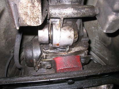

i ahve the same problem
I have exactly the same problem and it sucks. I got under the car and found my VSS sensor. It was leaking probably by an old O-ring. I haven't replaced it yet but I tightened the bolt a little harder and now the VSS is working a little better. By this I mean that when the engine is hot and driving at speeds over 35, the speedo will come alive. Before it didn't work at all. This is something and proves that maybe the VSS is the culprit. I will change it soon. They are about $55 at Autozone but need to be ordered. I was wondering if somebody could tell me if the leak may have something to do with it or not. Tracing the wires is kind of hard because the cables coming out of the VSS after a short distance goes directly up into the firewall area probably into the buffer or ECM. Could somebody tell me where the buffer is located. I know where the ECM is, but where can I see and check where the VSS cables are initially connected to. I understand that on 91 Camaro's the speedo is entirely electrical right?. So where is the cable going into the cruise control system. Sorry for all the questions but I am really curios to learn the entire wiring system of the speedo. I am attaching a picture of my leaky VSS. It is probably like yours.

Your '87 still has a VSS. It is built into the back of the speedometer in the gauge cluster. The ECU doesn't know anything about the cable driven part, but if the cable is bad and the VSS isn't spinning it could cause it to throw a code.
The buffer box should be located behind the driver's side kick panel if I remember correctly.
The VSS wire is teed into the cruise control after the buffer box. That's how it gets it's VSS signal.
