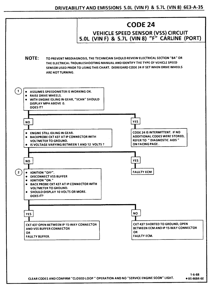

Try this chart.

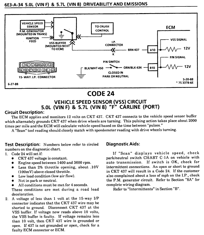

page 2

Wow I suck at wiring diagrams. Is there anyway to find out where exact the grounds are for the vss so I can check them or do I have to go through this whole process?
