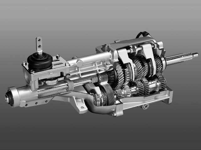

check out the companies at the bottom of this article. I have experience with G-force, Hanlon,and D&D, they are all awsome.
T5 article
T5 article
