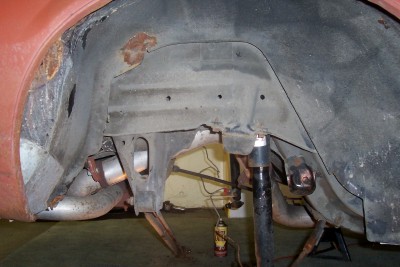

Just got my thirdmember installed, my Lakewood LCA's attached to the car, and I'm ready to huff this heavy thing in place tomorrow!
Attached Thumbnails Anyone running ford 9-inch? i need some help!-c-documents-settings-jeff

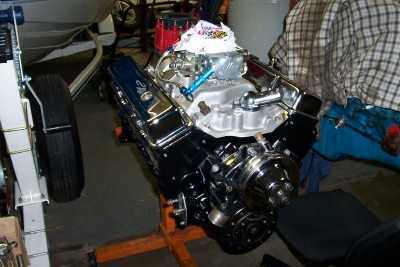

And the engine's ready to drop in after that...
