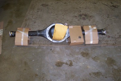

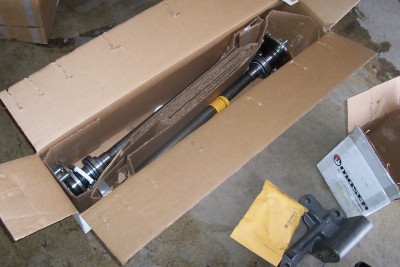

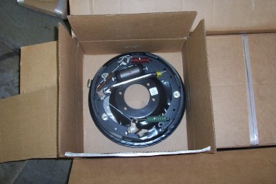

I got my 9" from Doug, (Quick Performance in Gilbert IA.) All said and done for the Moser housing, Strange center section, Richmond 4.11 gears, Moser 31 spline axles, Full spool, 1350 yoke, and the complete GM disc brake set-up for $2345, then another $115 for the braided brake lines and fittings to hook them up, if you rbuy his brake kit weather Wilwood or the GM stuff, buy the brake line kit from him, $75 and your done.
Like mentioned, you "details" are what's gonna cost ya. Also he told me they could not mount the brakes onto the rear end for insurance liability reasons, but I've talked to a few other that were able to get them mounted there. All I know, when I ordered my rear end I empasises I wanted a complete bolt in rear end that I just had to add fluid and bleed brakes. I got down there and picked up, an empty rear end housing, axles in a box, brake set-up in a box, 3rd member torque arm mount in a box, complete center section in it's own box that we found out had the wrong spool in it, then when I got home I found out it had a stock yoke on it. So I was very unhappy overall when I was promised one thing and got another, 4hrs round trip drive time, plus the time I had removing the yoke, and shipping it back and I got no discount for all the BS. Everything works good yes, but getting it there....PITA!!!
The Currie charges break down as follows:
Yellow Freight...................................................$230.00
Palletizing and boxing.......................................$27.50
assemble (install third member and axles)........$29.95
upgrade stock case to 9+ case..........................$120.00
gears, 31 spline Detroit Locker &
9+ big bearing support.......................................$999.95
Labor to modify disc brake brackets for
use on 9 in...........................................................$64.95
Currie performance axles.....................................$389.95
housing w/ torque arm bracket............................$549.95
$2412.25
Then I added the powdercoating for an additional $139.95. Now it can be more or less, depending what you order.
These prices were in 2002.

Arrived on schedule! Looks awesome up close!
Here's the housing:
Here's the housing:

Check out that beefly torque arm mount. You might want to take some close up pictures of the bracket and the tubes welded to the housing so others can see why it's not easy to just make one to install on any diff.

Originally posted by Confuzed1
Housing will have to be painted.....True-Trac posi...
to offset center so driveshaft is straight or is it on a slight angle to the pass. side?

Originally posted by zdrag28
are your axleshafts the same length or is one shorter?
I'm pretty sure the axles are the same length....and I'm sure the driveline has to be "in-line" to prevent torqing things at the wrong angle...
making driveshaft at a slight angle
I am in process of putting a 9" in my 86 and was wondering about this,both my axles are same length
