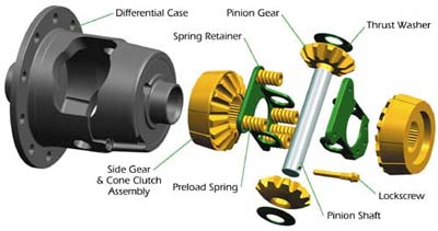

is the black/grey big piece on the left the carrier? cause it says case...omg i feel stupid...

The carrier is the posi unit itself. Yes its the grey piece.
The splines are on the axles- at the end where they slide into the posi unit.
The ring gear should be self explanitary-its the circular gear.
The pinion is the mushroom shaped gear that turns the pinion.
I don't have any pics, sorry, there are plenty at www.jegs.com or www.summitracing.com
the pinion gear they point to in that pic is for the spider gears inside the carrier, not the ring and pinion.
