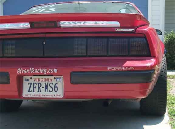

dose anyone have a pic of what a car looks like with the stock rims on and a 4th gen rear i would like to see the differance

My next replacement rear for both my 3rd Gens will be 4th Gens -- awesome 12-inch rear PBR brakes and I like the wider track of the 3rd Gen wheels extended to the fender line. Here's a photo.

i dont have a pic but the outer edge of my tires are basically dead even with the little lip on the fender. mine looks like it is a few fractions of an inch in tighter than the one in the pic posted.

well thanks for the pic as no one had shown a pic and i tried to picture in my head a 2 inch differance lol
but it wasnt working so well
