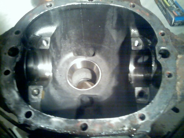

Ok so i got everything disassembled today and installed new races in the axle housing.
I now have a question about my pinion depth. So the used 3.73 pinion i got has the inner bearing still pressed on it. So could i replace the inner bearing and use the same shims? And how can i determine my correct pinion depth?
Sorry the pics might be a little blurry. Numbers on gears= 11-41 2N
Any info is greatly appreciated! Thanx

If you put new races in the housing then you need to use new bearings too. The original shim is a good starting place, but may not be the correct shim for the housing that you are using. Setting the pinion depth is a trial and error process and requires assembling and disassembling everything several times to get it right.

ok yeah i'm replacing all the bearings. I am assembling everything untill i get the correct backlash and bearing preload right? Thanx for the info

Pinion depth is the hardest to get right. Setting the bearing preload and backlash are not that hard.
