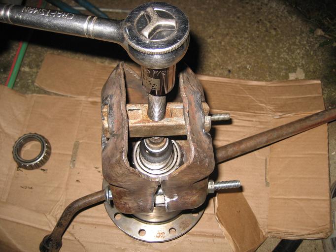

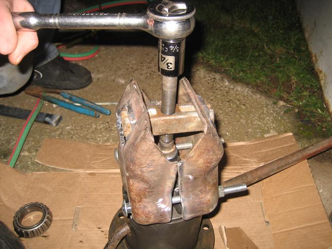

I needed a bearing splitter/puller, didn't want to buy cheap one and didn't have the money for the goods so I used my engine mounts...
Didn't expect it to work but I got both the diff bearing off so far only one was totally trashed.
Attached Thumbnails Just use your engine mounts to pull those diff/pinion bearings-bear-split-pull.jpg   Just use your engine mounts to pull those diff/pinion bearings-bear-split-pull-t.jpg   Just use your engine mounts to pull those diff/pinion bearings-bearing-pulled.jpg

hahahaha awesome, hey whatever gets the job done

Well it didn't work so well on the pinion bearing. The one motor mounts started to take on new shapes and bent one of the 1/4 inch mild steel adapters I made for pulling from the longer shaft. I'll try a real tool for that one I guess, didn't mess up the bearing too bad though.
