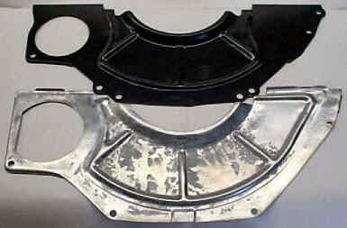

86-92 F on top:
http://www.garage-scene.com/images/a...ust_shield.jpg
And I guess you could compare it to the one from Mass. on eBay.

86-92 F on top:
