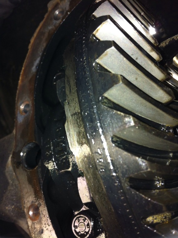

Have a leaking pinion seal and decided to pull the cover. The oil looked brand new just a little low. I know it is a peg leg pull but can you tell me what gears these are. Also I have the chance to get the rear diff out of a 1995 Camaro. Will it fit with no problems. It is the 10 bolt and has drum brakes.
I assume it has posi. Will pull the cover to confirm this.
What should I look for when I pull the cover to see what it is. I will post pictures when I inspect it. What gear would a stock 1995 camaro have that comes with drum brakes. I would think it was the 3.1 engine model.
Here are the pictures. (the pictures are of my current rear end and not the 1995 rear diff)

...can you tell me what gears these are.
13/42= 3.23's. The following may be useful:

Yea, it's a 3.23 gear. A '95 rear end from a V6 car is probably going to have a standard differential. It will also have 28 spline axles, so if yours is a '89 or older your axles are going to be 26 spline and you can not use the differential anyway.
