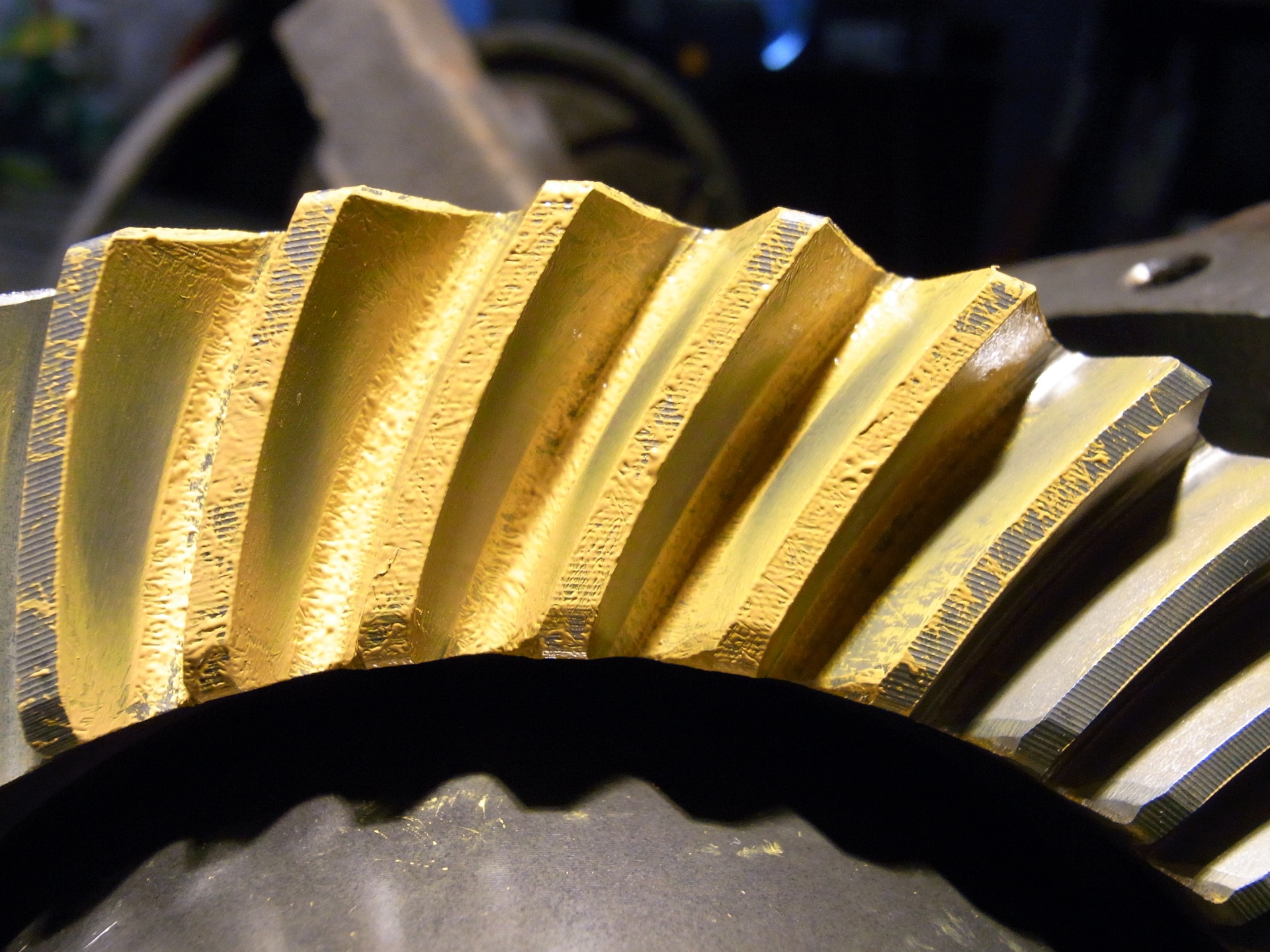

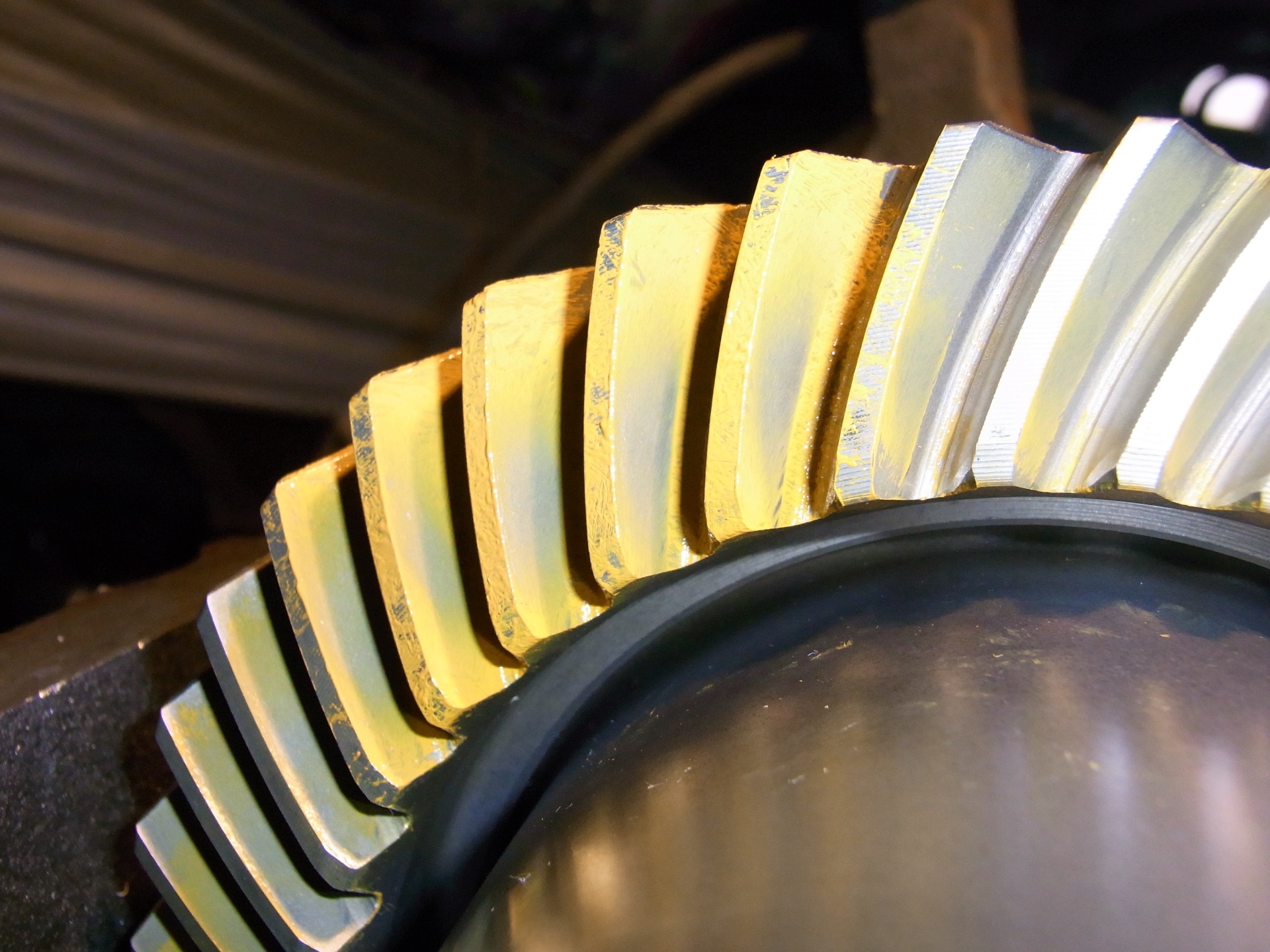

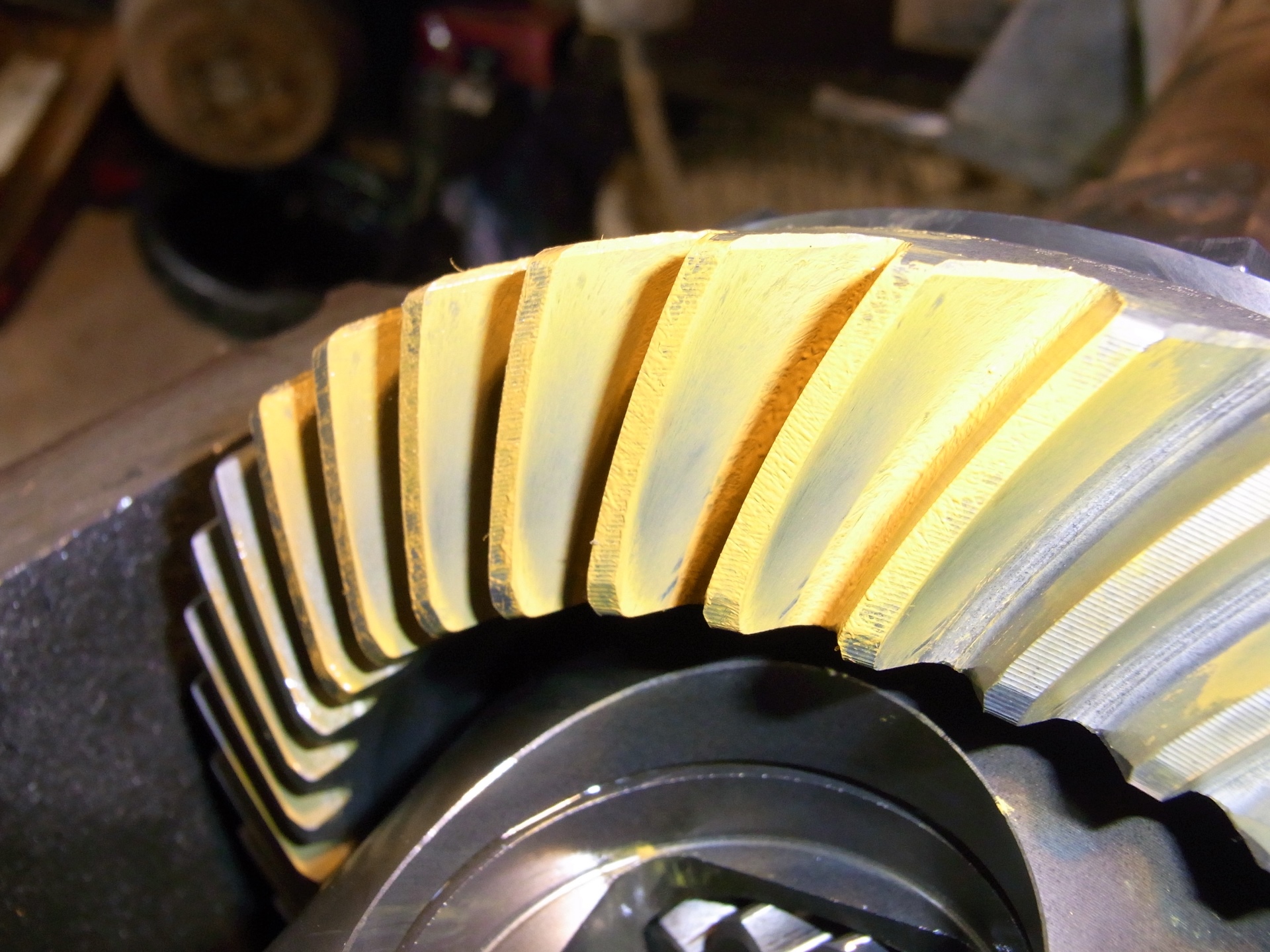

Turned the gears using the axle like you said. Seems now it is a bit far out on the heel on the drive side, and a bit towards the toe on the coast side. Might also be a bit towards the root on both.
What do you think?

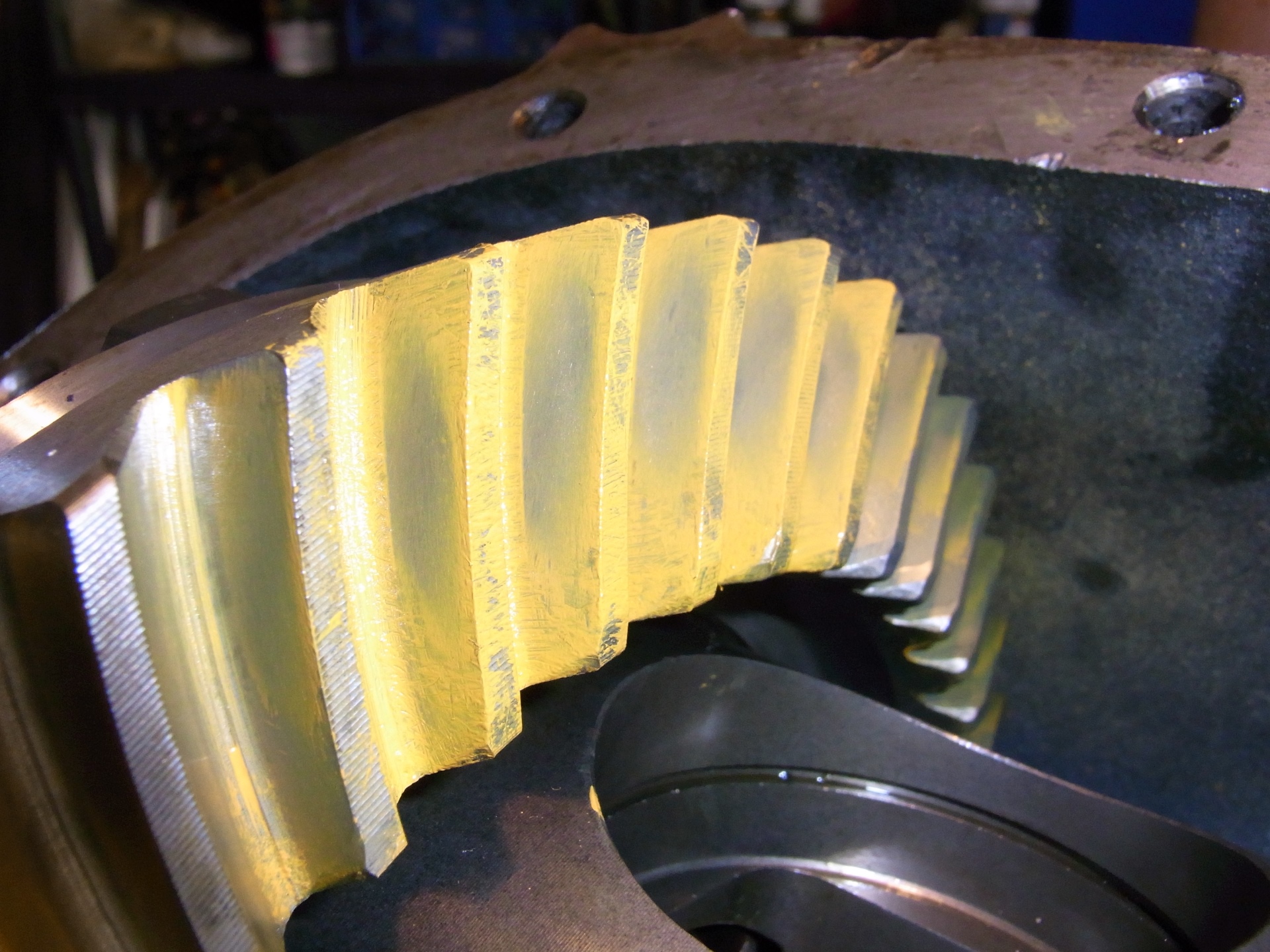

Derceased the pinion shim and moved the carrier about a hairswidth towards the passenger side. Backlash measured to 0.007". Came back with this:
Seems a bit toward the heel on the drive side? And a little toward the toe on the coast side?

In post number 4 the pinion is a little too deep. How much did you change the pinion shim for the pictures in post number 5?

Pinion depth is the same for picture 4, 5 and 6. Between pictures 3 ad 4 I went from 0,9mm to 0,8mm. Or from ~0.035" to ~0.032", according to good old Google.
So you think I should increase the pinion back to 0.9mm?

No, I think you should keep going in the same direction a little more. Try a slightly thinner shim, about .030 inch, and see if it brings the coast and drive patterns closer together. Right now you have a drive pattern that favors the heel and a coast pattern that favors the toe. See if the thinner shim will bring them both closer to the center of the tooth. Keep the backlash within the recommended specs.
