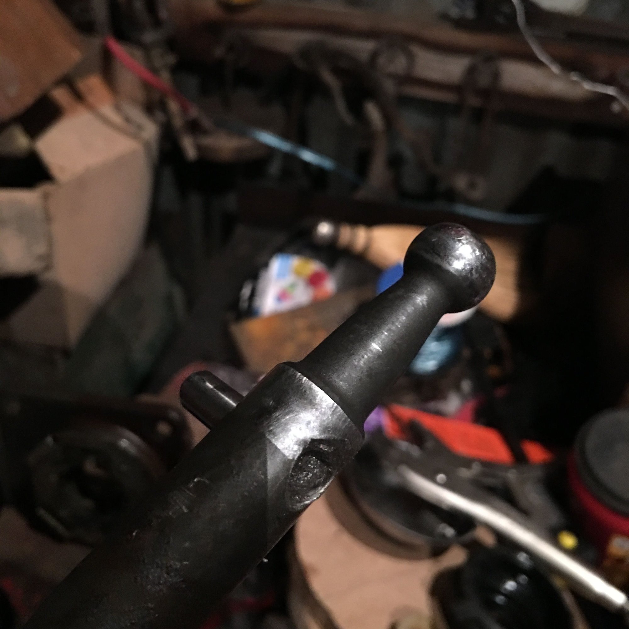

In the above picture is the shift rod and the pin is broken on the right side. I believe that happened a long time ago, but I never put enough force on the shifter to make the one side pop out of place from where the pins are seated as pictured below.
So my first question is should I get a new shift rod? I read something about those pins actually being one pin that can be removed from the rod, so is that a thing? My dad thought we could weld a pin onto the other side, which I guess is another option.

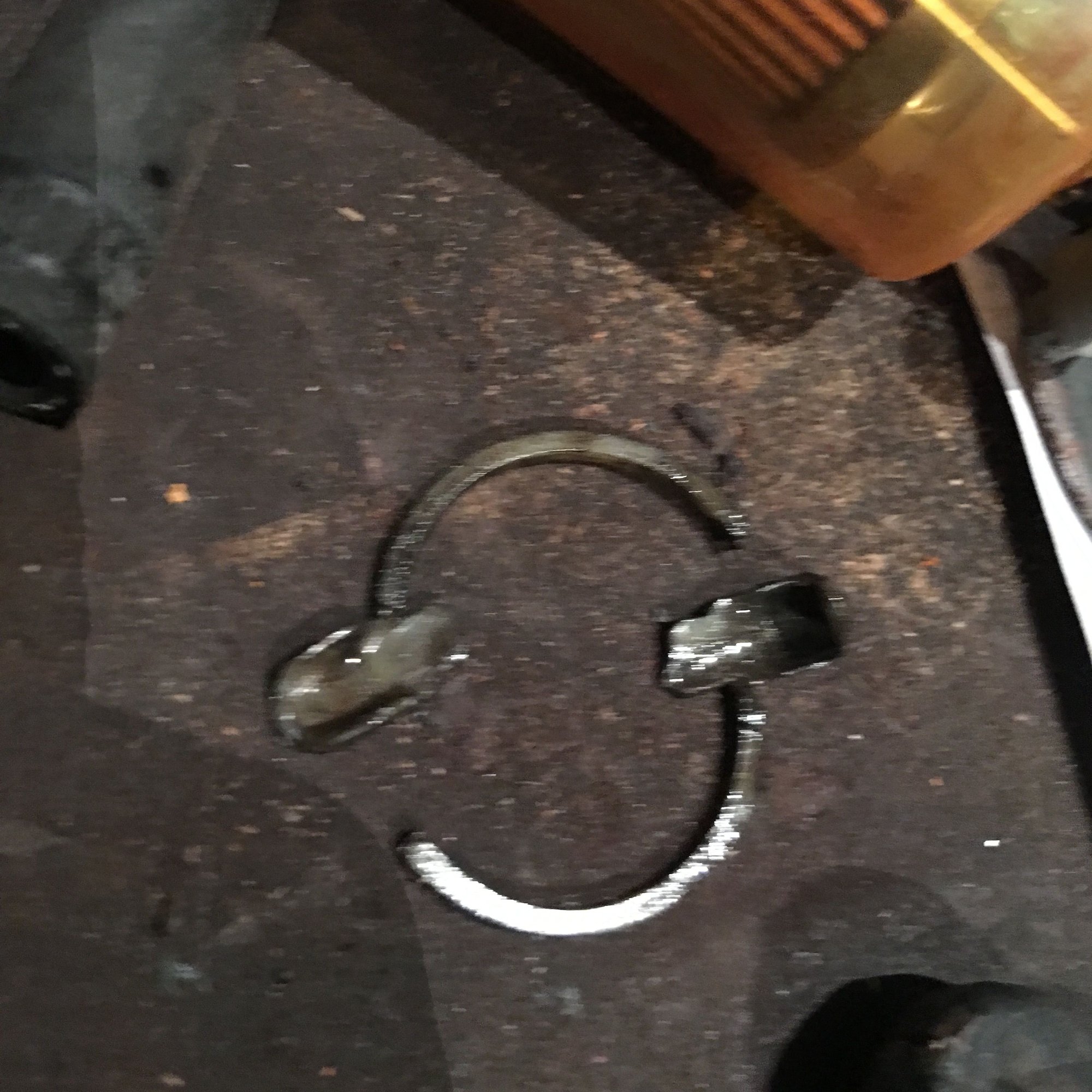

My second questions is what is this and where can I find it? It's that little plastic ring piece that rests over the pins and kind of protects it them from wearing down when being pushed against the spring, but I can't seem to find it anywhere.

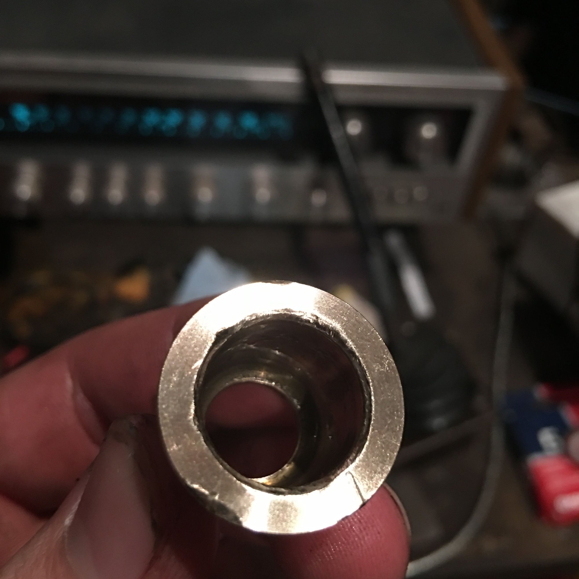

And my final question is should I be worried about this shifter bushing? It's bronze and I recently put it in in April this year, but it's a little rough around the inside edge.

I don't know if you're going to find parts for the stock shifter without tearing another used shifter apart.
I always liked the Hurst Comp-Plus for the T5. But, there are other options available these days.
The bronze bushing up top just shows wear from the shifter hitting it. I always just replace the bushing with a stock one, secured with adhesive.
