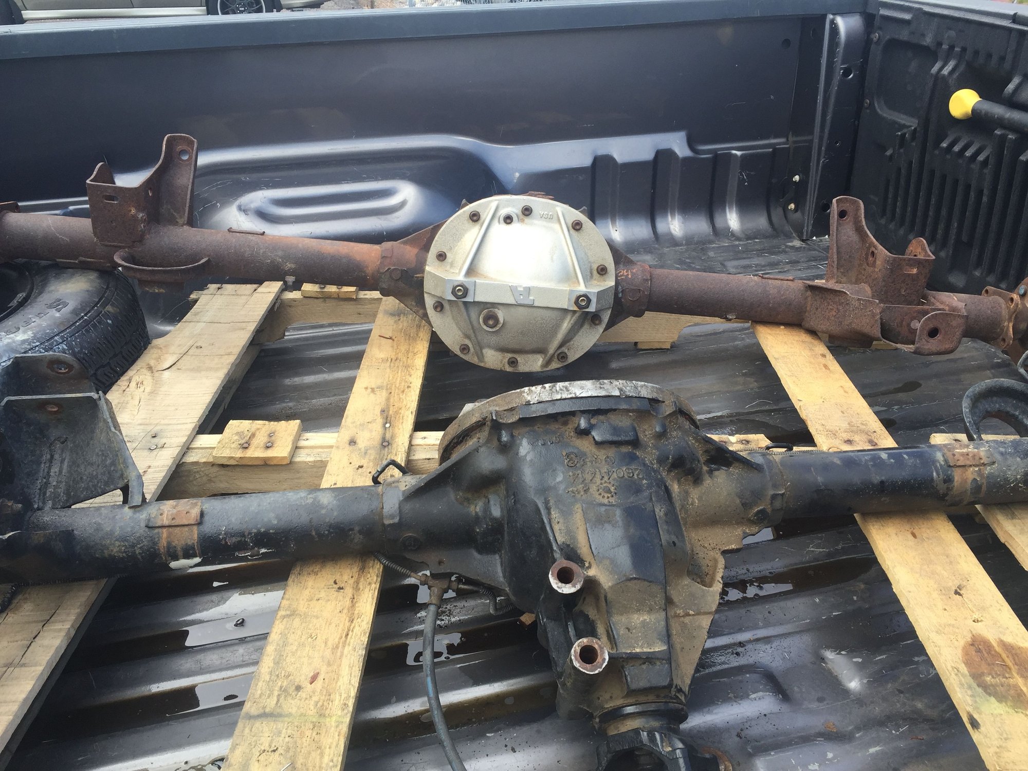

Confirm this is a 4th gen rear?
Found a guy selling 2 rear ends from '98 ls1 cars. The stock one doesn't include brakes and is from an auto car. The other has an aftermarket diff cover and is supposed to be 343 gears. I'll be driving a hour and a half to get them but I will pull the cover to get a better look. Both for $175. I just wanted to make sure they are 4 th gen fbody rears before I waste my time and money.
-thanks

Re: Confirm this is a 4th gen rear?
Looks like it to me. I don't recall any 3rd gens having the speed sensor on top of the housing.

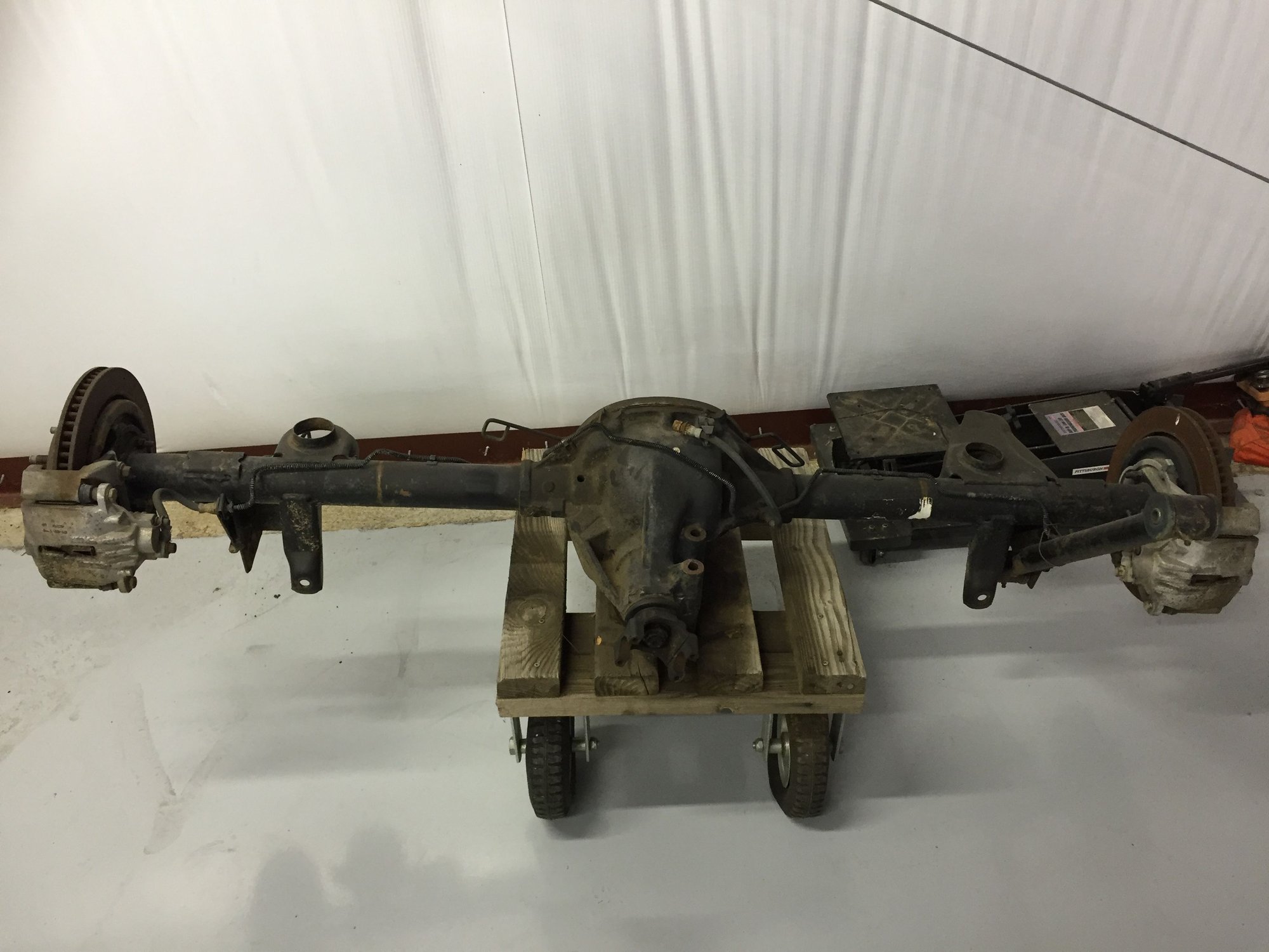

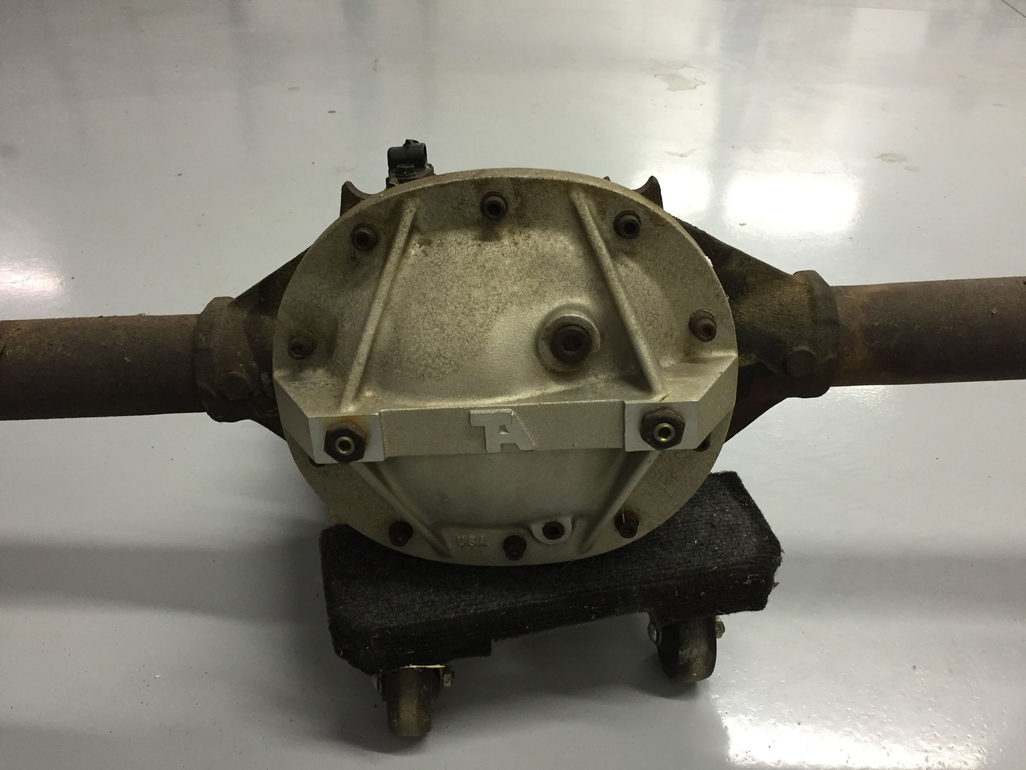

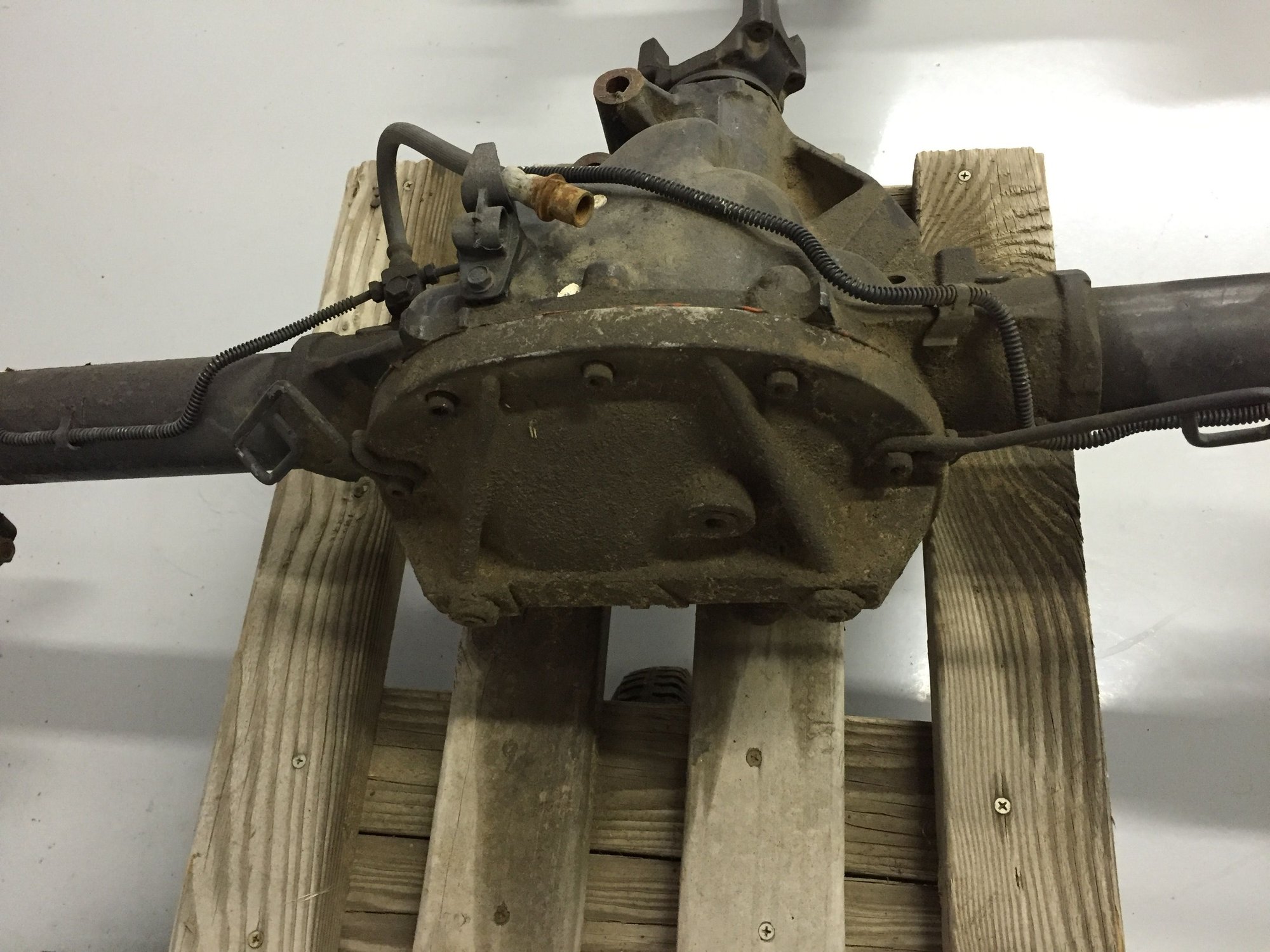

Well after a 4 hour drive round trip later I've got both rear ends in the bed of my truck. Snapped a few pics-both have the "TA" diff covers. One is supposed to be 2:73 gears and the other a 3:43.
This must be the auburn since it has springs I'm assuming?
Do these numbers mean anything?
No springs like the other-is this a zexel torsen?
You scored the torsen
Not sure if you can see well enough by these pics but do they look ok? To me nothing looked out of the ordinary-gears looked fine with no metal shavings.
Old Apr 13, 2016 | 09:13 PM
big gear head's Avatar
Joined: Sep 2008
Posts: 3,777
You got one Auburn and one Torsen. The Auburn has a 2.73 on it. Can't tell what the other one is.
I didn't notice before, but the rear end with the Auburn has a bearing cap stud kit in it.
It looks like the Pinion teeth has rubbed on the auburn diff? It looks like teeth-marks on the diff centre, no?
Old Apr 25, 2016 | 02:26 PM
Joined: Sep 2008
Posts: 3,777
Either the pinion nut came loose or a pinion bearing failed at some time. I've seen them a lot worse than that.
