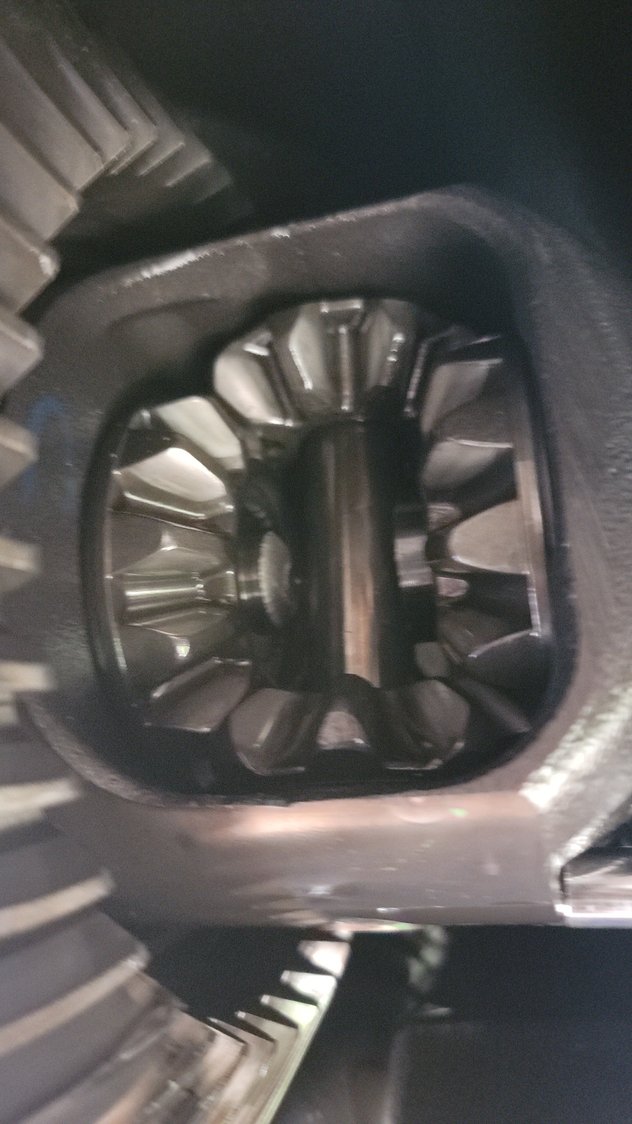

I know my 82 was recalled for C-clip issues, either the clip wasn't wide enough or the groove was too wide. They fixed it in the mid 80's but it always clunked.
Fast forward, it finally uttered a final clunk and destroyed the spider gear a few years ago.
