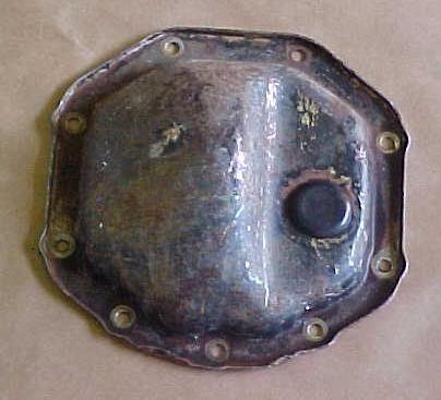

The easy way to tell is to look at the punkin cover.
A 9 bolt had a rubber plug in the cover near the top.
The 10 bolt has the 3/8 plug in the side of the yoke.

Equally easy:
A 9-bolt cover has 9 bolts.
A 10-bolt cover has .... you do the math.
If a rear has a Gov-Lock in it, it won't be a 9-bolt.

The Best Way,Find The Rear Axle Code On The Axle Tube It's Most Likely Rusted Over And Difficult To See,But It's There.

No factory installed L69 Camaro EVER got a factory installed BW rear end - period.
