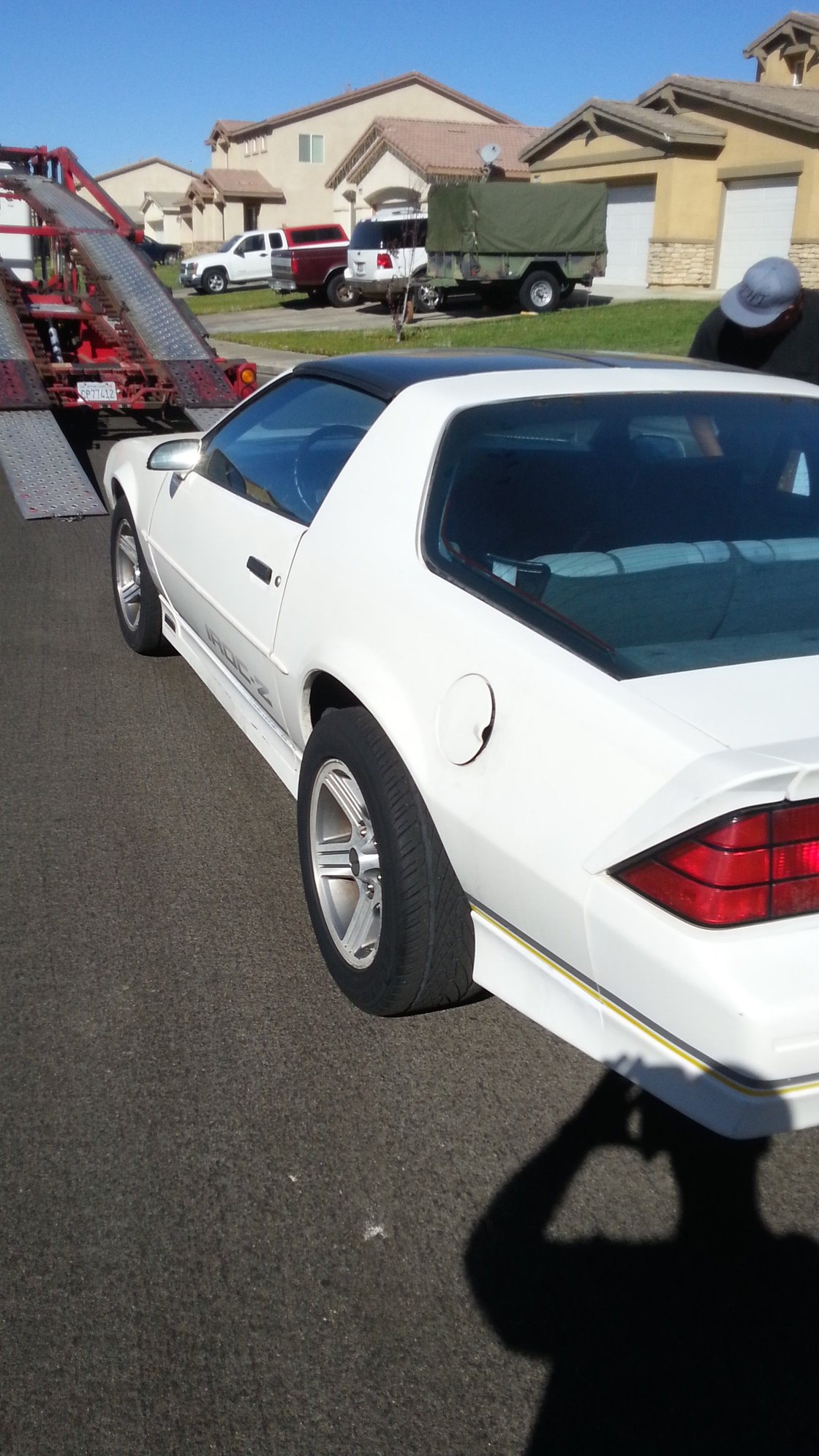

Yes, you can use the stock wheels. Yes, they will stick out about an inch or so.

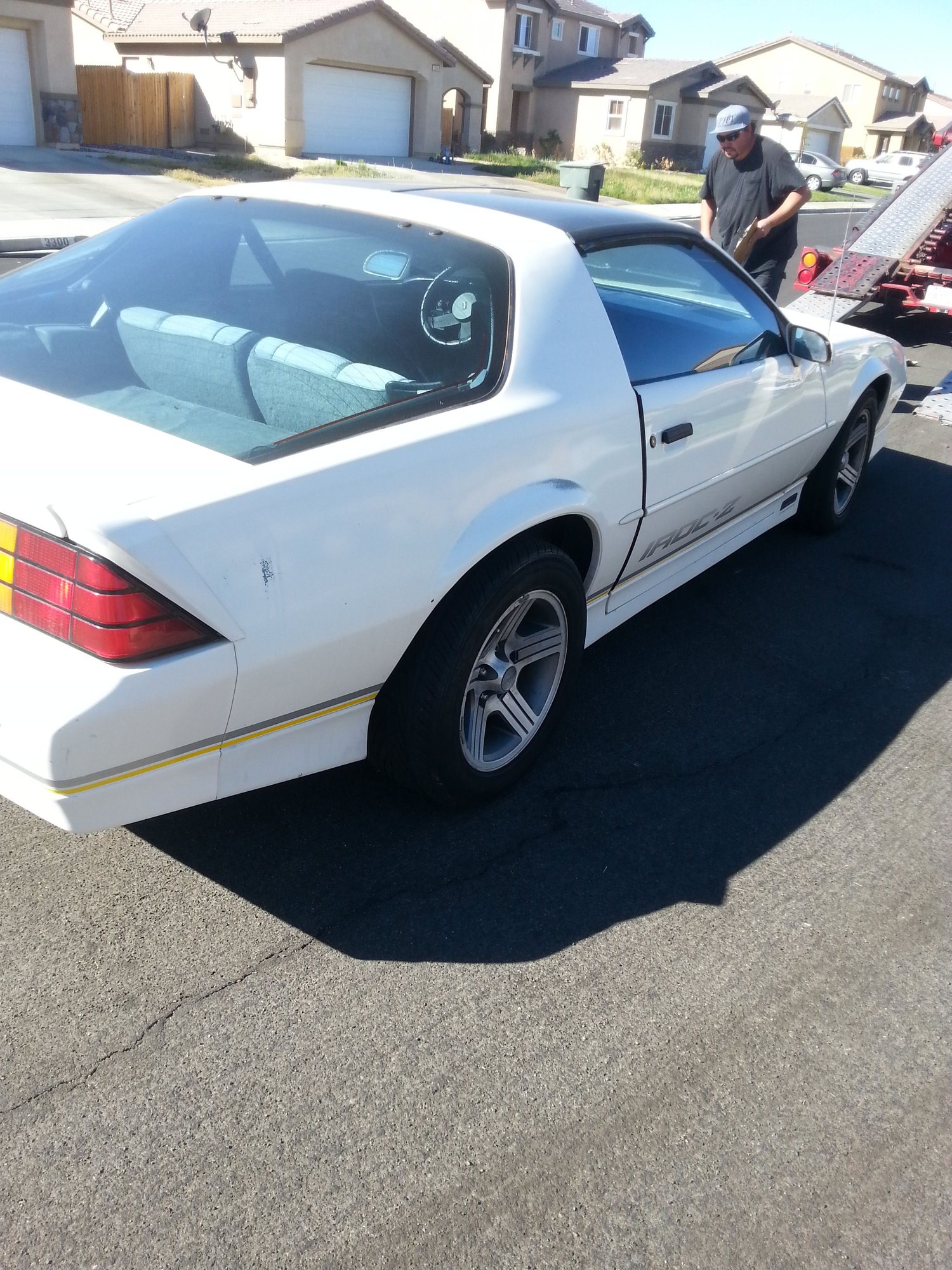

I recently did that swap. They do stick out just a bit past the fender lips. I have my stock wheels currently. I lowered it at the same time. It doesn't look as bad as I thought it might, but I will change wheels eventually.

Stock Wheels with 4th gen rear
