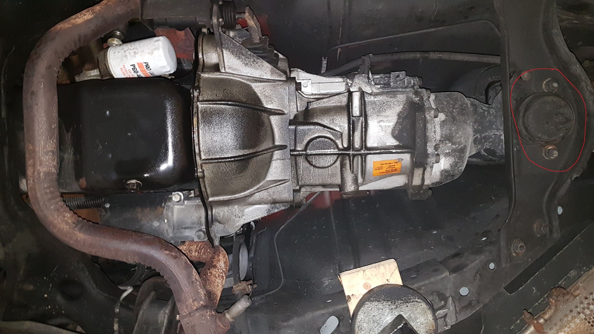

hello i need for my 3.1 firebird with a 5 speed manual a transmission mount
cant find one on the internet the v8s use a different one
maybe someone can help me thanks

That's the oddball hydraulic mount.
It would be worth your time to just change it to the standard mount and crossmember from a V8 car. The crossmember is easy enough to find in most pick a part yyards, eBay or the classifieds here on tgo

thank you do you know why the v6 use a different one when the bolt holes of the trans are the same ?
is the v6 with a manual so rare?

This mount also appeared in v8 cars, no idea how or why it was chosen.
My v6 car had the standard mount, granted it was an automatic stock. I kept the mount when I converted to manual years back
The manual was uncommon in these cars period, most are automatics. The manual in a firebird seems to be more uncommon that in the Camaro from what I've seen too.

Thank you i replaced it with a standart mount and a v8 crossmember
works fine now
