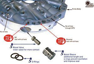

Drop your pan and make sure the reverse boost valve is all the way in
Old May 11, 2018 | 11:51 AM
Liquidsteel's Avatar
Joined: Jan 2006
Posts: 51
Re: 7000r4

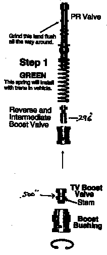

Should be close to filter in the pump. Snap
ring holds in place
Old May 11, 2018 | 03:45 PM
Joined: Jan 2006
Posts: 51
Re: 7000r4

thanks the snap ring was down low so i pushed up on the valve and worked the snap ring up and YESSSSS locked into place, now works
