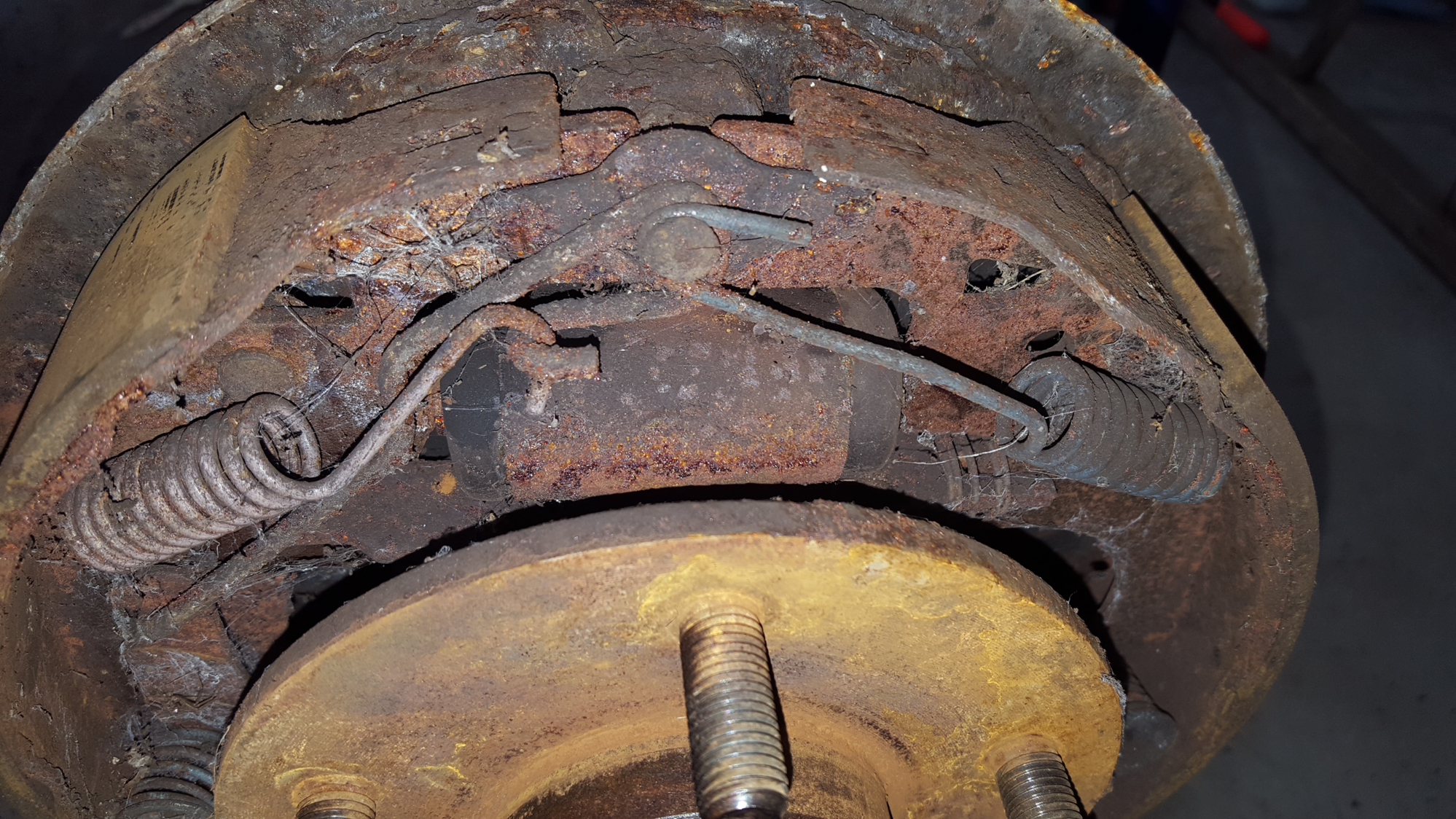

Thanks for the imput guys! I think I have enough info now to find the correct bearings and cables so I can start rebuilding the diff. My dad and I were wondering how long it was setting under water or partially submerged because the entire underside of the donor car was rusted out so bad you could roll the car by putting your feet through the floor like the Flintstones. I have a few pics of my rusty brakes attached

1986 ACDelco E-brake cables from Rockauto are about a half inch longer than the 1990 ACDelco Cables according to their specs

There's a changeover in there from manual adjustment, to the self adjusting lever. Use the cables that match the car, ie the parking brake lever.
