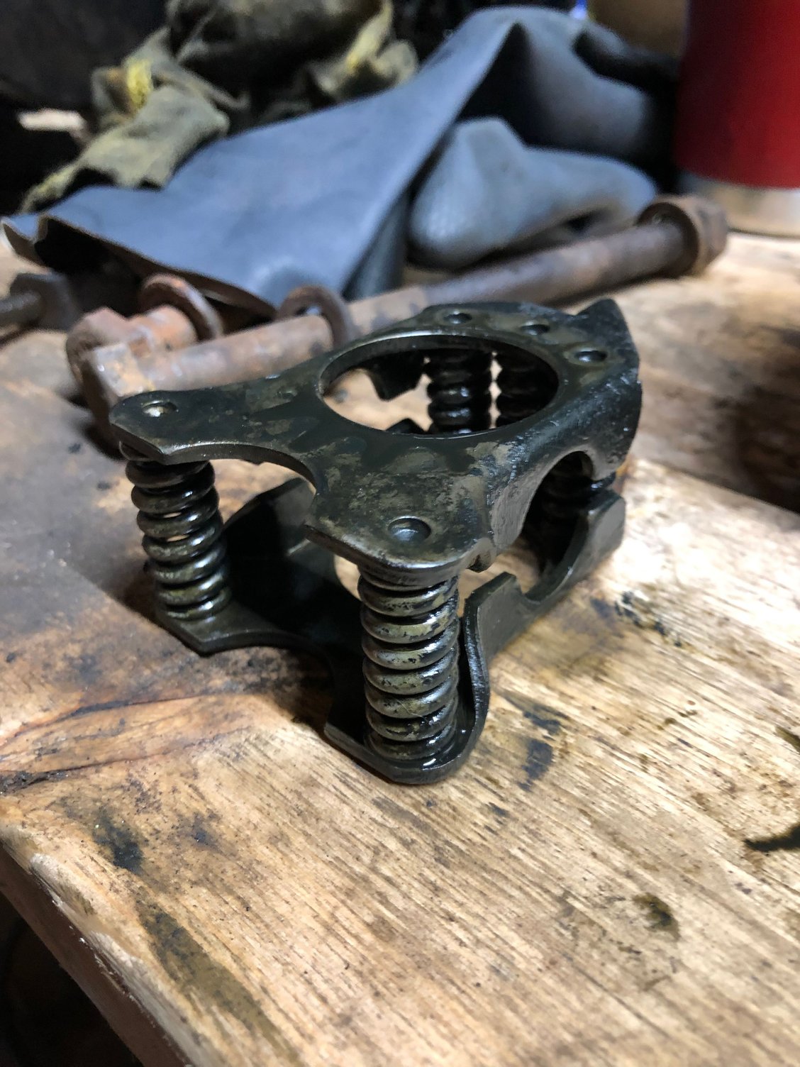

this unit came out of my 82 z28 wondering if anyone knows what brand it is or if it is rebuildable?

Borg-Warner LSD for a 9 bolt.
EDIT. I was wrong about this. It's not a BW, it's the old style Auburn that bolts together instead of having the cap on the end. It can not be rebuilt. I need to take a little more time and study things before posting. Sorry about that.

Weird bw 9 bolt. Has center pin and spring plate. Not 4 spider cross. Probably an auburn cone posi like from an impala?

Garbage. That's what that is. Cone type posi that's worn out.
