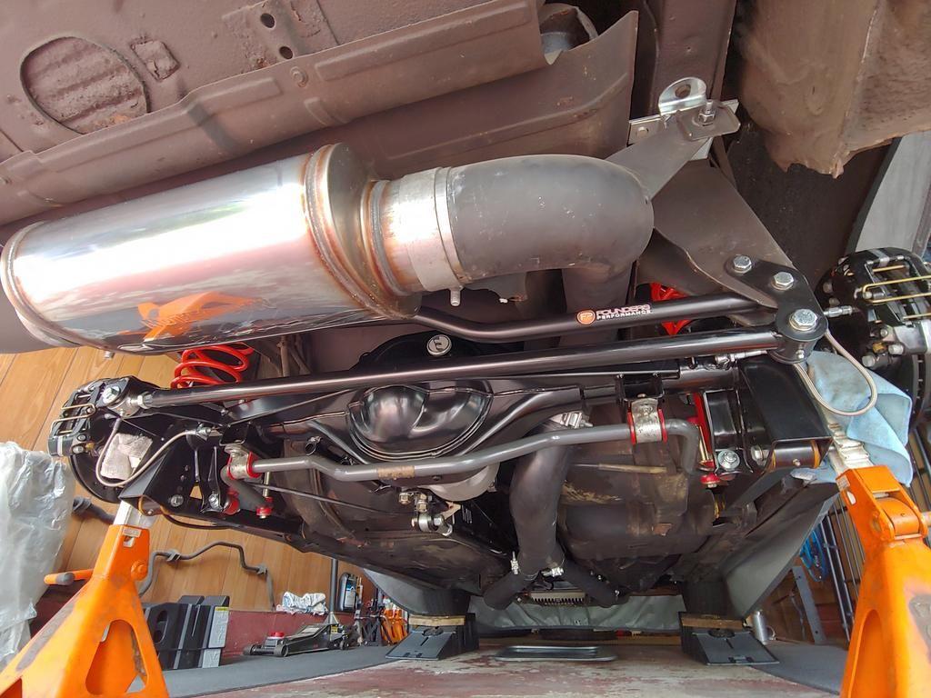

The Quick Performance fabricated housing with BMR weld on sway brackets installed and a coat of primer.
Yukon through bolt aluminum center section. 3.70 ratio and Eaton Truetrac posi.
Finally making some progress. Got the center section from QP last month and finally got the sway bar brackets from BMR two weeks ago. Should have ordered the brackets sooner. never would have thought it would take so long to get them. Main thing is they are very nice laser cut pieces and welded on nicely. Just finished a coat of primer. Probably will wait until next weekend to do the first coat of semi gloss black. At this point, with the summer season over, I probably wont get this guy installed this year. At least I'll have it ready to go in first good weather next spring. Slow progress but still progress. Bright side is, no added miles on the car this year. Also saved alot on gas and collision coverage this summer. Now that the 9" rear is all bought and paid for, I can hopefully get the new front struts and the few pieces I need for the transmission, including speedo gears and have it all ready to install at the start of next season.

I've heard mixed reviews on their 9", and getting a $1500 center section in a bucket drove me nuts

I've heard of issues too, but only when using an adjustable torque arm with their funky bracket. I see they've beefed up the mounts at the top and bottom of the housing where their bracket attaches. When used with the wrong kind of TA, these mounts would break off. The thing is, you don't really want to use their bracket at all. It will work for now to install the axle with the stock torque arm. But probably next summer I'm going to install the one piece adjustable torque arm from Midwest Chassis and Suspension. MCS builds their own 9" housing with TA mounts in the same spot as QP's. They also make a nice TA that attaches directly to the housing at those top and bottom mounts. It looks to be the way to do it.
I don't know much about QP's factory Ford housing conversion. I know that the QP housing my buddy runs in his 72 Chevelle is very nice. This fabricated housing is a completely custom piece, built from scratch, and looks to be very well done. The welds are some of the best I've seen anywhere. If there is an issue with this housing, I can't imagine what it would be. I will see if there are any clearance issues with my car's lowered ride height. If so, I'll have to clearance the rear of the tunnel to fit. From what I've seen though, this style of housing with the TA mounts top and bottom of the housing don't have the same issue with clearance as the housings with the square mount block. Again, we'll see when I go to install it.
The bucket mustbe their F**k You for not buying the Jazz Protecto case. For what it's worth though, The bucket did a great job of protecting the center from damage. The bucket and a big box full of stuffing.

I had my rear axle for over a year and not one problem.

for your sway bar mount did you just use a 3" u bolt clamp? did you have to space it out more? got a better pic of it?

It is just a 3” muffler clamp . I ended up putting about a 1/2 spacer in there.

It looks like I still end up at around 180lbs total weight, even with the fab housing and aluminum case, lighter than a factory 9" or 12 bolt though. I want to stay as close as possible to the factory unsprung weight of the rear axle. In any case, I should have a rear axle that can take all that I'll ever throw at it and more with a gain of only about 25lbs.
Did you get a final weight? How does that compare to stock?

Can you believe it? I finally got my 9" ford installed. Here are some photos. The carnage I found when I pulled the cover on the 7.5 was legendary. The pinion gear was in chunks. So weird now not to hear a loud whine from the rear end when driving the car. Used to keep the tunes up high to drown it out. The job went nearly perfect, with just two minor snags. I ordered the center with a 1310 yoke thinking that the 7.5 must have the small yoke. Turns out the 7.5 used a 1330 yoke with a 1310 to 1330 conversion yoke at the rear of the driveshaft. Had to switch the rear u joint to a 1310. Then, when I had it all done and went to drive it, I found I had only first gear in my built 700R4. Somewhere while moving the car from my garage to the flatbed and from the flatbed to the hoist, I lost my governor gear. A new gear and shes now good to go. Of course, with the air here filled with smoke from the wildfires, I only drove her home and tucked her safely away. Hopefully the air clears before the fall rain sets in so I get some chance to drive her before shes go back into storage for the winter.
Next is finishing the exhaust, then a little more beefing up of the trans, then the new motor.

I see in your first pic that your shock is angled about as much as mine to the rearend. Everything on mine is adjustable so I thought I got something out of wack. Did you set the pinion angle before or after that first pic? I made adjustments to fix this problem as the rear looked like it was in a bind. I am setting my pinion angle tonight with an angle finder to see if I corrected it or not. After more reading on the forums I am not sure I had the pinion angle setup right the first time around,

I checked with the car hanging on the hoist. It was right at 1.5 to 2 degrees. I will recheck when I have it on the flat rack tonight. I noticed that my shocks were at a weird angle on assembly. The bracket QP sends with the housing is pretty much set for near zero pinion angle and doesn't really allow for much adjustment. It barely lines up with the brackets welded to the housing. I will run it this way only until I get the Midwest Chassis and Suspension torque arm. It bolts directly to the brackets on the housing and is adjustable. It's the ideal solution when running this housing.
