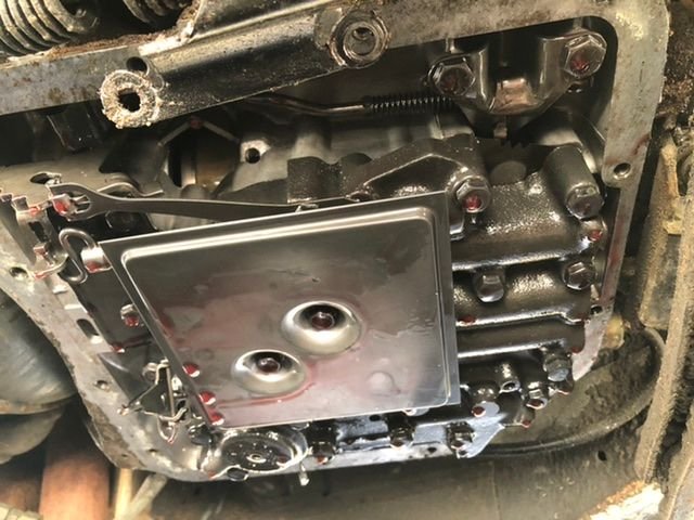

I just dropped the pan, here is what I see. It’s a th350 right?

Doesn't look like a 700r4 for sure. The 700 has a nearly square pan. 13 bolts holding the pan ? If so it should be a TH350 or derivative.

Yes indeed , that is not a 700R4 , here is what the insides of a 700R4 looks like .

PS , looking really close it looks like the vacuum line may not be properly connected to the vacuum modulator (rear of the transmission on the passenger's side) , which would cause all kinds of shifting weirdness .....
the hose is connected, I traced it up to the intake. It connects at a tee on the passenger side intake near cylinder number 8. The hose is a soft rubber, should it be a firmer hose since it is vacuum? Is the modulator going bad perhaps?
