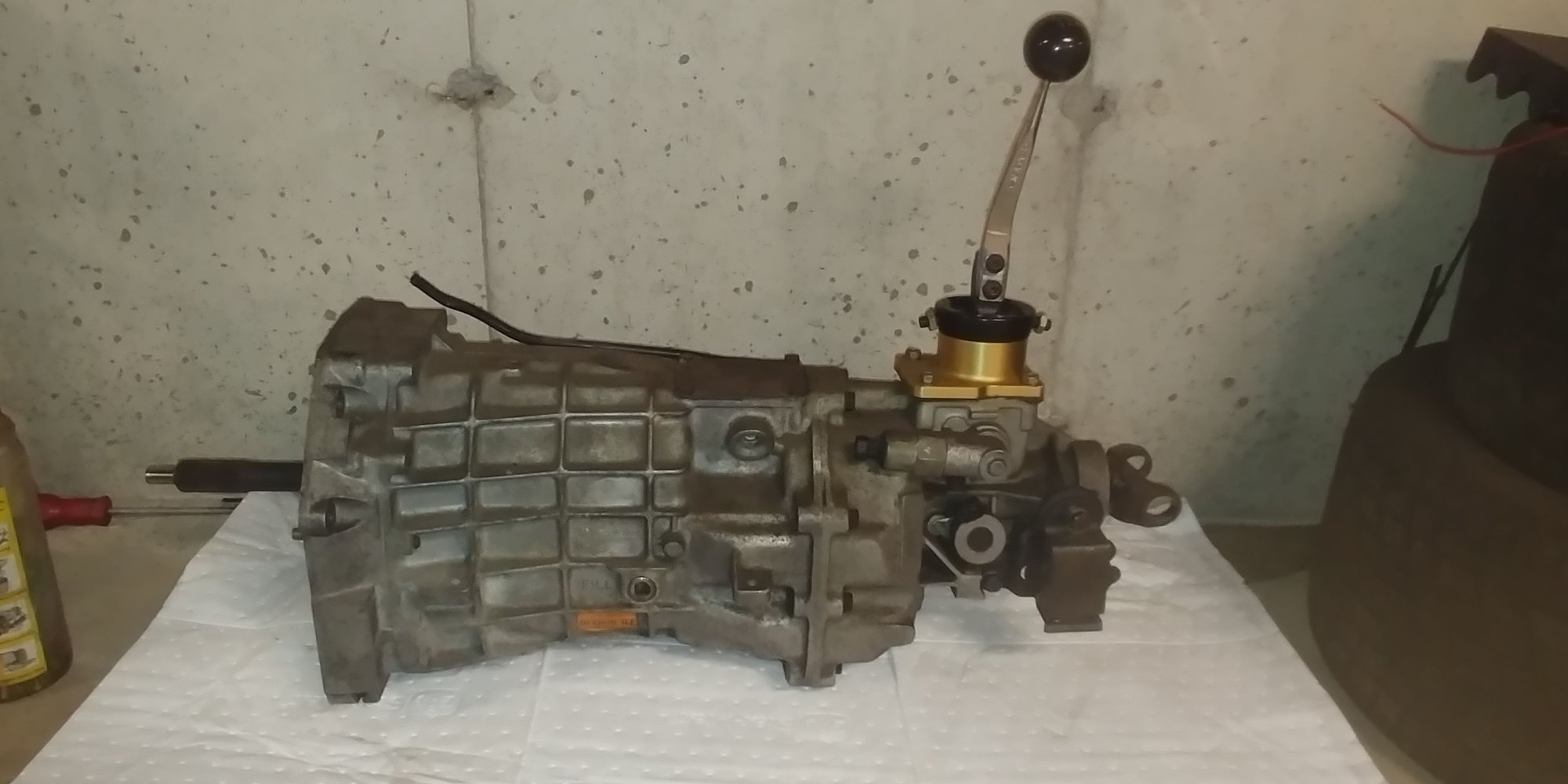

Here you can seethe tailshaft difference from a LT1 t56

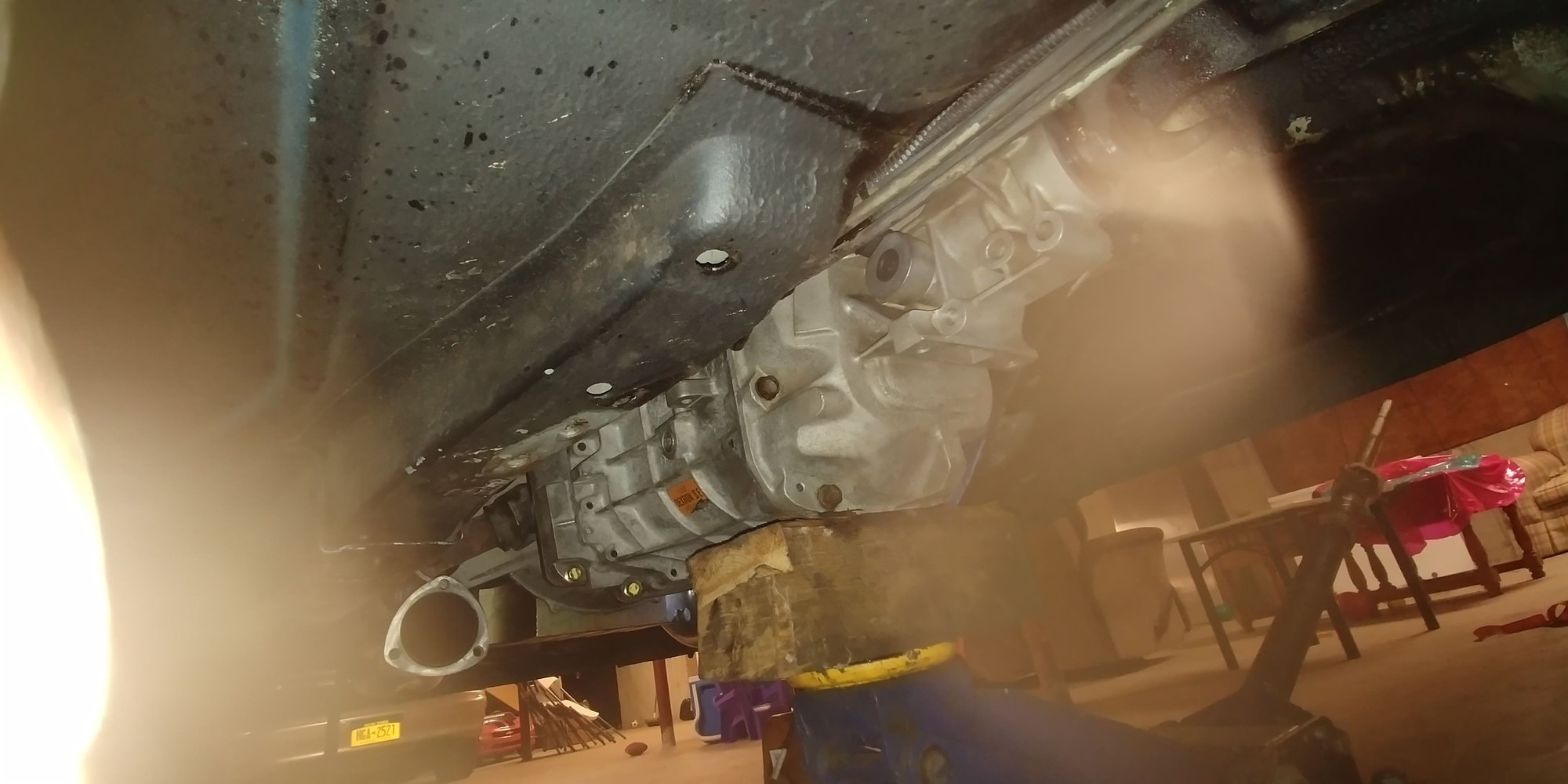

If i remember right this is the height it went in at. Sorry bout the blur

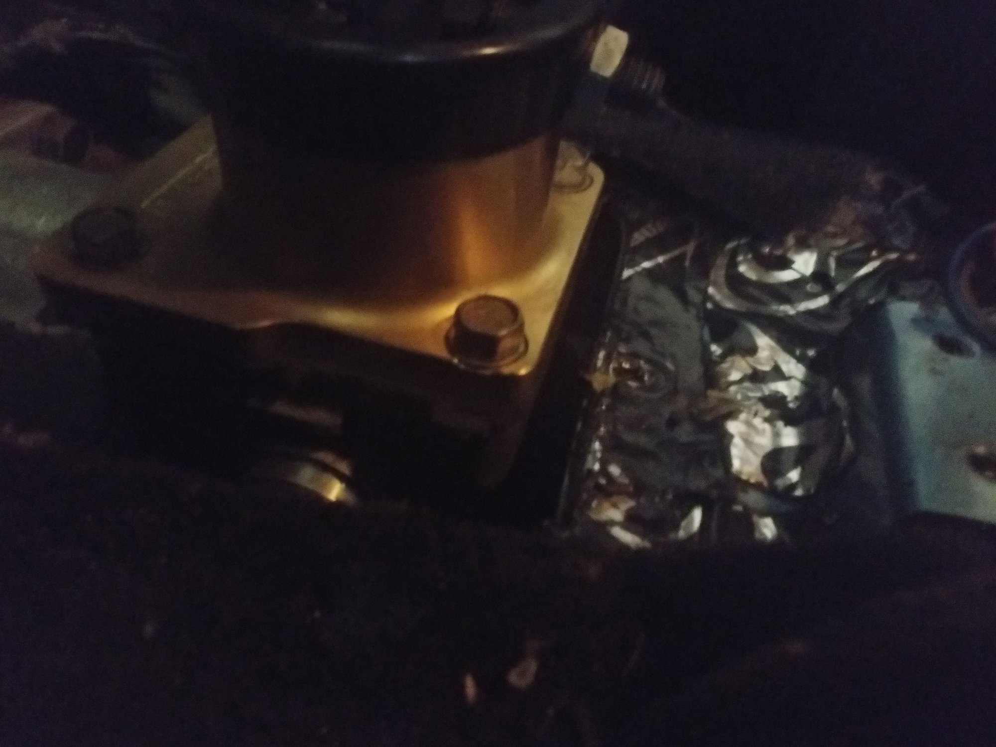

Looks alright! Here's mine.

For my part, I just used a pry bar and massaged the floor a bit at the contact point. It did the trick
