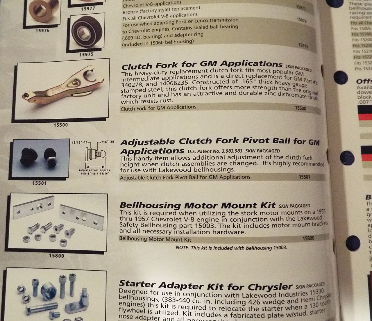

Could try searching for Mr Gasket 3855G. My 1998 Mr Gasket catalog says it's the same as the Lakewood 15501, lists it for ALL GM applications, and recommends it with all Lakewood bellhousings. Pretty sure I've got a 1998 Lakewood catalog around here somewhere too, but I'm not having much luck finding it. Autometer, Lunati, Milodon, Lingenfelter, Mr Gasket...
Oops, spoke too soon. Went to put the Mr Gasket catalog back on the shelf and found the Lakewood book. Not a ton of info, but there you go.

Well, I think their applications program is defective. It says this item has a 13/16 thread which fits older GM products but certainly not mine. Who knows.
Anyways, Camfire Dave on Ebay said he'd send me a nice used OEM one instead of the listed one. If that comes true I'll be a happy guy.
Thanks and wish me luck.... Thanks Drew, the catalogue also shows the thread to be 13/16 which is not exactly compatible with the part that fits with a M22-2.0mm thread
Good thing I didn't try to get it, sheesh!

You could always cut the stud off the ATP part, then drill/tap it 7/16-20 and thread in the Lakewood stud. AKA turn it into an adapter.

Drew's suggestion is a totally solid solution when you want to solve the issue without welding to repair.
The 84-92 V8 bellhousing ballstud is M22 x 2.50 thread.
This seems like a good solution, but the Lakewood one mentions hardened steel. If the ATP part's steel is as cheap as it seems to me wouldn't that present a problem withstanding the pressure that the threads put on it during usage. Seems like they might not hold. Now I do still have my old original one that is much harder steel. IF I could get it tapped I would feel better about doing that.

The weakest mild steel is going to be stronger than the cast aluminum bellhousing. I wouldn't worry about it.
