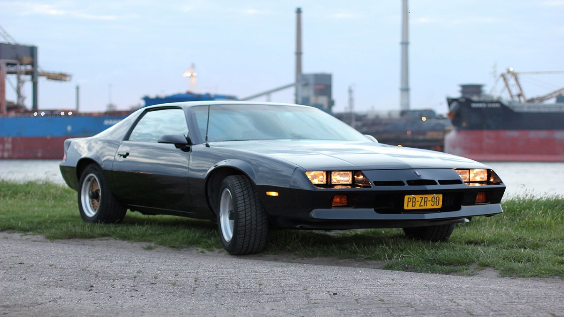

Hi guys,
Let me introduce myself.
I'm Max from the Netherlands and acquired a 1983 (the engine and transmission are swapped from a 87 model) Chevrolet Camaro last year.
I am in the progress of removing some parts, exhaust manifold, and other bits.
Now I'm in the progress of removing the transmission, as it leaks heavily and was looking to beef the transmission with the G-Force Heavy Duty case.
I'm pretty sure I got a NWC T5, but my question is if I can use the gearset out of my NWC case and put them in the G-Force one.
Is it possible to rebuild the kit with WC parts aswell? Bearings etc. I would like to use the Heavy duty countergear stabilizer plate aswell.
I am looking forward to some replies!
Thanks again,
Max
